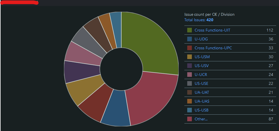

The Goal: We want to create a Pie Chart based on a saved JQL filter. The chart should be grouped by a specific custom field named 'OE / Division' using the "Statistic Type" setting in the gadget's configuration.
The Problem on our Production Server: The chart shows an extra bar with the name 'Irrelevant'. (screenshot below*) And the bar on testsystem is not showing --> thats  how it's supposed to look.

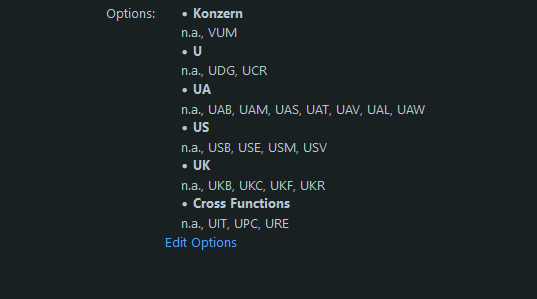

this is the Select List (cascading) custom field config with some options:
The Mystery on our Test Server: Here's the strange part: Our test server is a clone of our production environment. We replicated the exact same setup there:
  1. The custom field 'OE / Division' shows the same "non-standard" warning in the admin backend.
  2. The JQL filter in the gadget's configuration also shows the same syntax error warning.
  3. However, on the test server, the Pie Chart gadget renders correctly and displays the data exactly as we need it!

It should look like this (this is our testsystem)
But it looks like this (this is the production system)

Have you checked the cascading select field, do they have the same options?

Im talking about the standard pie chart by Atlassian. I have checked every single option in the fields option. Everything is set the same. Will try to run a full re-index.
