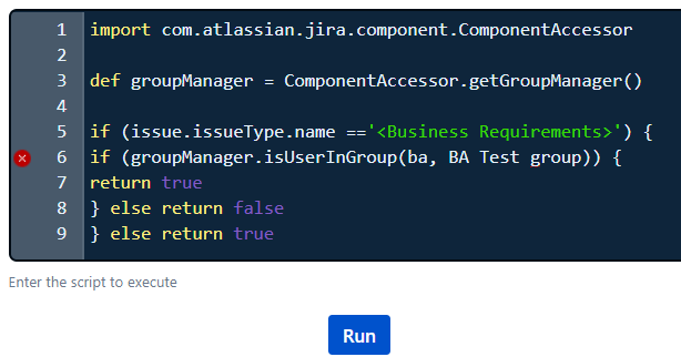

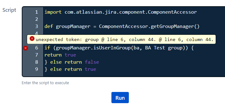

Hello,
I'm getting multiple errors while applying the above code. One of them is attached.
Basically, I want to restrict the access for BA (under BA Test group) for creating/viewing the Business Requirement issue type (custom issue type).
Please advise.
Thanks,
Vishu
1. You need to replace whole <Issue type name>. Is should be 'Business Requirements'
2. Group should be:
if (groupManager.isUserInGroup(issue.reporter?.name, 'Ba test group')

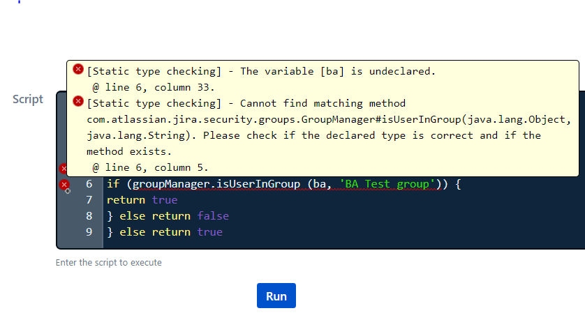

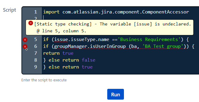

Tried the above code and got two more errors. Sorry, I'm new to scripting in ScriptRunner.
Hi
What is the 'ba' variable in line 6? Where do you declare it?
Error from line 5 - where you put this code? Script console, validator, console?
ba is the username of the user who is in group "BA Test group".

Currently, I have tried running this script in ScriptRunner console but it should be run in Validator of the workflow, right?
Please advise the script for the above. Thanks :)
To test it in Script console you need to define issue and put user in ''.
Script should look like this:
import com.atlassian.jira.component.ComponentAccessor
def groupManager = ComponentAccessor.getGroupManager()
def issue = ComponentAccessor.getIssueManager().getIssueObject('issueKey')
if (issue.issueType.name =='Prośba o usługę') {
if (groupManager.isUserInGroup(ba', 'BA Test group')) {
return true
} else return false
} else return true
