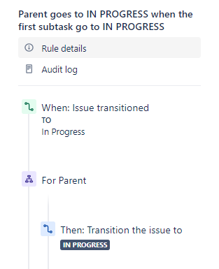

Parent goes to IN PROGRESS when the first subtask go to IN PROGRESS

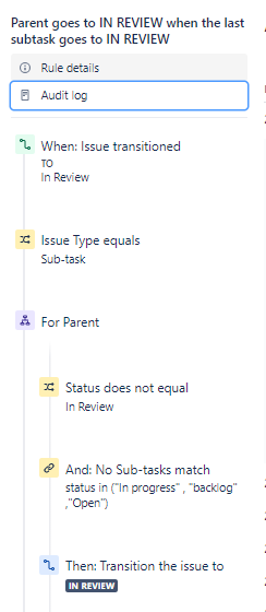

Parent goes to IN REVIEW when the last subtask goes to IN REVIEW , all the other subtasks are already IN REVIEW, or in TESTS or CLOSED

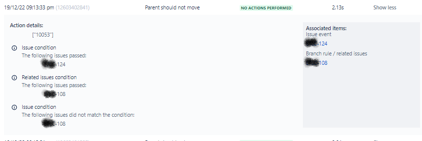

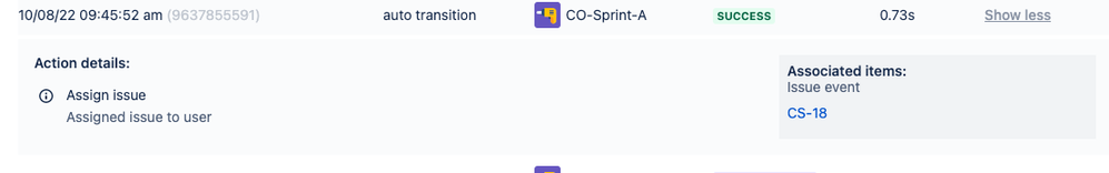

HI @Trudy P Claspill ,
I have attached the audit log details along with the rule.
Please check and let me know where I am doing mistake?
How did this not perform the way you expected.
The audit log with the timestamp of 09:09:11 indicates the parent of the subtask had its status changed to Test, in accordance with the rule.
The audit log with the later timestamp of 09:13:33 indicates that the second condition you specified for the parent was not met, so the status of the parent issue was not changed.
That second condition is "parent issue status is not in (Test,Closed)". The first run of the rule set the parent to Test. Since the status of the parent is already Test, the condition fails and the parent status is not changed. This is correct behavior for the rule. There is no need to change the parent issue to Test when it is already set to Test.

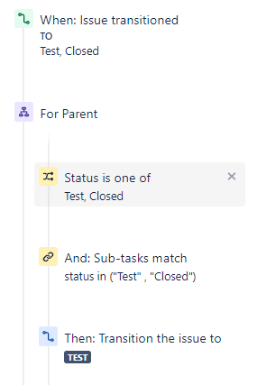

The above is indicates When subtask is "Test or Close" - Move the parent to "TEST"
But my Criteria is , When Subtask is changed from Close to test( Workflow is moving back from right to left)
Parent status should not change.

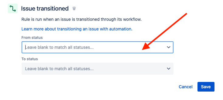

I am not able find the "TRANSITION THE ISSUE TO ?"
In the above rule you need to modify the Trigger to specify the starting status of the issue during the transition.
Using that field you can indicate that the rule should only be executed during the transition to Test or Close if the issue was coming from one of the acceptable statuses (i.e. Open, In Progress, Test, Review). Do not include Close in that field, and then the rule will not execute if the issue transitions from Close to Test.

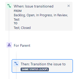

When - Issue transitioned
From- Backlog,open,Inprogress, Inreview,Test
To - Test, Close
For Parent
Transition the issue to :- Copy from trigger /same status as loop
This is not meeting my acceptance criteria.

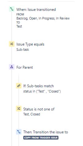

For this rule:
Parent goes to TESTS when the last subtask goes to TESTS, all the other subtasks are already in TESTS or CLOSED .
First I'm going to restate the same thing in the order you would develop the rule:
(A) WHEN: a subtask transitions to Test
(B) FOR: the subtask's parent
(C) IF: all the subtasks are in a Status of Test or Closed
(D) AND IF: the parent issue is not in a Status of Closed
(E) THEN: transition the parent issue to a Status of Test
Here is the rule:
(1)TRIGGER: Issue Transition
- From Status: Open, Backlog, In Progress, In Review
- To Status: Test
(2)CONDITION: Issue Fields Condition
- Field: Issue Type
- Condition: equals
- Value: Subtask
(3)BRANCH RULE/RELATED ISSUES:
- Type of Related Issue: Parent
(4)CONDITION: Related Issues Condition
- Related Issues: Sub-tasks
- Condition: All match specified JQL
- JQL: status in (Test, Close)
(5)CONDITION: Issue Fields Condition
- Field: Status
- Condition: is not one of
- Values: Test, Close
(6)ACTION: Transition issue
- Destination Status: Copy from Trigger issue
Mapping the rule statement elements to the constructed Rule:
(A) is handled by (1) and (2)
(B) is handled by (3)
(C) is handled by (4)
(D) is handled by (5) - this is what prevents the parent issue from moving right to left
(E) is handled by (6)
I recommend that you create one Automation Rule per Sub-task status.
Please try to extrapolate the other rules from this example.
