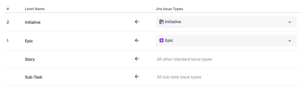

You can extend the hierarchy by creating additional levels. These will always be above the Epic level. You do so via Advanced Roamaps Settings > Advanced Roadmaps hierarchy configuration:
In this example, I added an initiative level above epic. The approach you used to create separate projects for the additional issue types is fine. I did the same. But make sure you also map out the issue types to the corresponding levels here. Repeat the process for additional levels. Based on your scenario I would expect to see:
  • Base mapped to the story level;
  • Epic at level 1, where it is by default;
  • Features at level 2, above epics
  • Course at level 3, above features
You cannot skip levels in the hierarchy. That means you cannot create a parent - child relationship between a feature and a base (task), as that would mean you are skipping the epic level. So that is a first thing that may not match your expectations.
