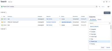

Hi @Louise Mitchell
I assume you are using Issue Navigator and using Parent Link in your JQL and you want to see the Parent Link field values for the issues shown in the Issue Navigator.
For that, you have to add Parent Link field using Columns dropdown, which is on the top right corner. Once the column Parent Link is added, the issue results will show the Parent Link field values as another column
Please refer to the below screenshot:

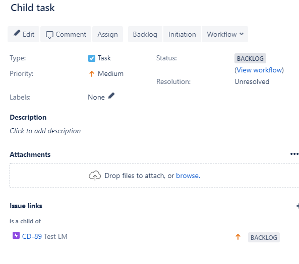

Hi @Louise Mitchell ,
Can you post screenshots of the view issue page of the issue that you are looking and the issue navigator screenshot highlighting the issue that had parent link on view issue page but not showing under parent link column.

Louise Mitchell
June 17, 2019
Hi Ravi
This is the details screen

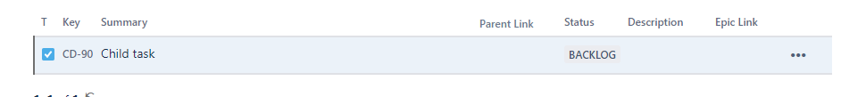

This is the filter with Parent Link column

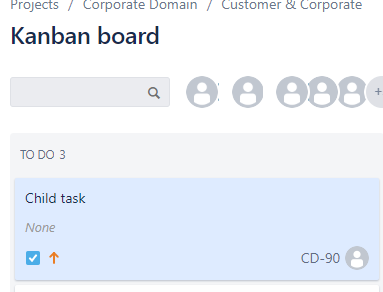

This is the Agile Card on a Kanban Wall with None

Ravi Varma
June 18, 2019
Hi @Louise Mitchell
You should be using linkedIssue in the JQL

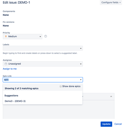

First Solution
On the Issue Edit screen, you should make sure that Epic Link field is available.
Refer to the below screenshot, where you can select one of the available Epics on the Edit Issue screen

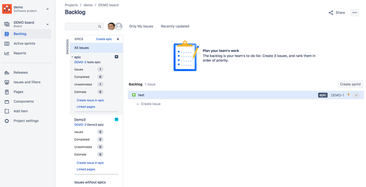

Go to the agile board, backlog screen (click on Epics) as shown in the below screenshot and drag and drop the tickets in backlog to the desired Epic. I would prefer this way, as it is easy and intuitive. You can even create new epics on the fly.

Louise Mitchell
June 18, 2019
YAY!
Solution 2 works
All i need to do is move the issues back to the backlog and I can drag and drop them in
