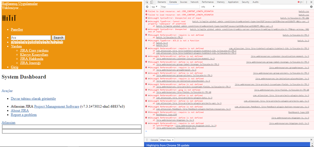

When i'm trying to access jira via 'help.company.com' on LAN, login page loaded but it does'nt seem properly. There are 21 errors on Developer Console (Chrome).
help.company.com from WAN is OK, there is no problem.
localhost:6050(apache url) is OK, but this time 'mismatched base url' error appeared. I must access Jira via base url.
What should i do to solve this problem?
Thank you.

My first screenshot taken from inside network and with base url.
