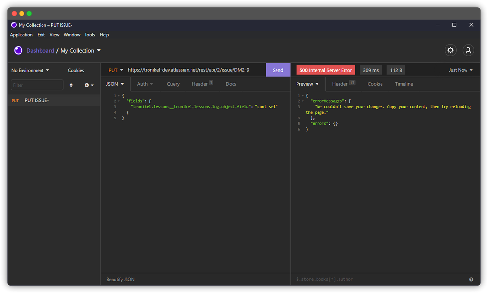

I’ve encountered a problem when calling PUT /rest/api/2/issue.
Jira Cloud responds with 500 and
  "errorMessages": [
    "We couldn't save your changes. Copy your content, then try reloading the page."
  "errors": {}

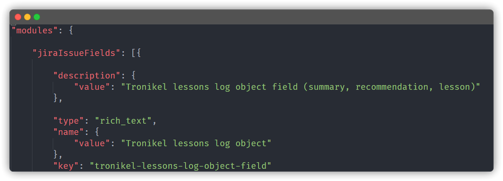

 The field that I want to edit is an ace app Issue Field with type “rich_text”
More context to this error:
So, I am building an ace app, which has a connect module → Issue Field:

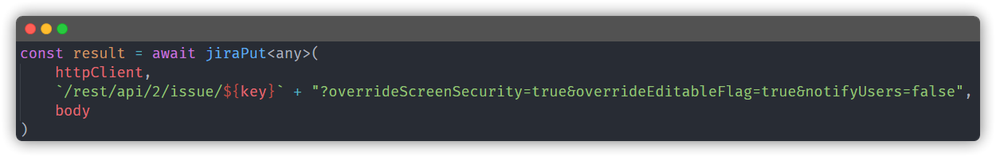

This field gets assigned/updated to a Jira Issue through my app, the request is shown below.

When I call the PUT request for the first time (on an issue which does not have my field assigned) it updates correctly.
But when I change the value and call PUT a second time (the issue already had my field assigned) the error pops up.
And, also, when I call PUT with the same value as the first PUT, it works.
e.g.
  1. I create an Issue
  2. Call PUT, value get saved correctly
  3. Add a random letter to my current value at the end and call PUT, get error
  4. Remove my random letter at the end and call PUT, then it works

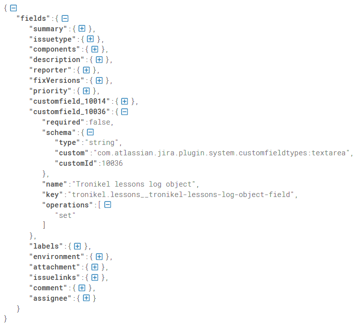

This is what I'm getting when calling /rest/api/2/issue/{issueIdOrKey}/editmeta:
So, does this mean that I should be able to edit the issue field?
The full response is here, if it'll help: https://hastebin.com/agoluqozos.json

Yes - if a field is in the edit metadata is should be updatable.
