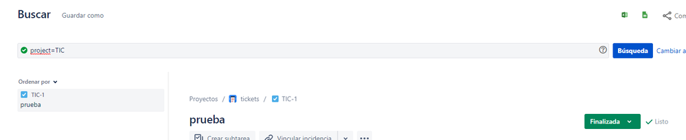

I have an issue, when i do a jql query in jira web the result is correct like this:

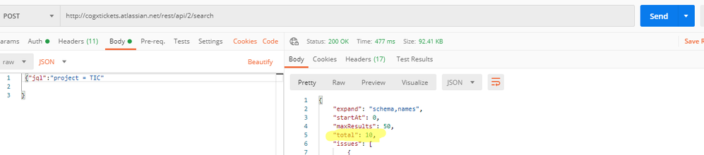

But, when i try the same query with postman, jira allways return all the tickets in my jira. like this image:
jira2.pngWhat could be the reason?

Hello @cogx_tickets
I believe there are some wrong parameters in your Postman request. Could you please try to run the following REST API endpoint (URL) directly in your browser and check if it works for you?
   https://cogxtickets.atlassian.net/rest/api/3/search?jql=project=TIC
I'm not a specialist in the Postman app, but I believe you might be able to get the information you want by following the steps below:
  1. Since you're trying to return information from the REST API Endpoint, you shall use GET instead of POST method
  2. Since you are trying to return information from a Jira Cloud site, use the version 3 in the URL directory:
Let us know if this works for you.
