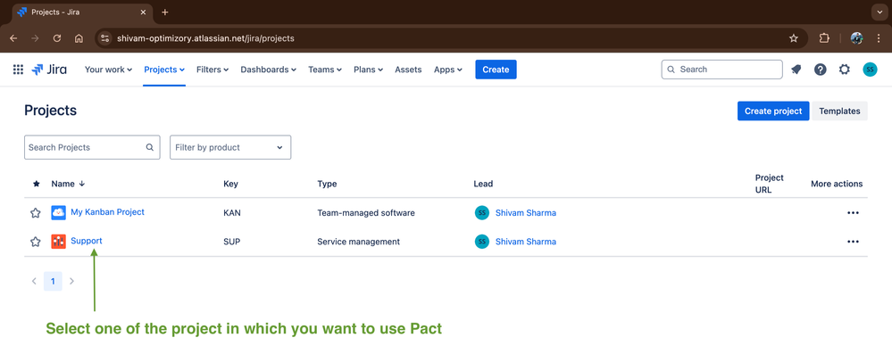

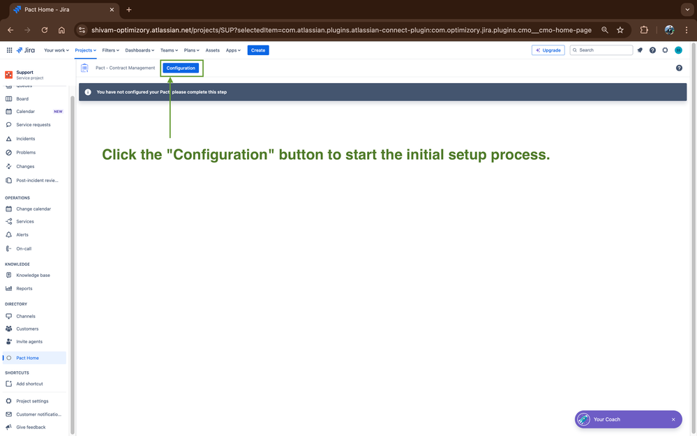

To access Pact, follow these steps:

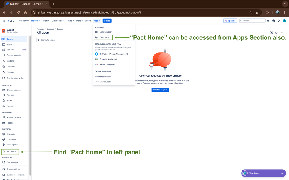

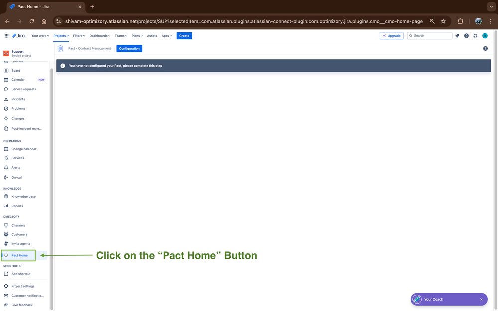

  2. Find the "Pact Home" button: It's located in both the Apps section and the left sidebar of your project page.2nd.png
  3. Go to the Pact Home Page: Click on the "Pact Home" button.3rd.png

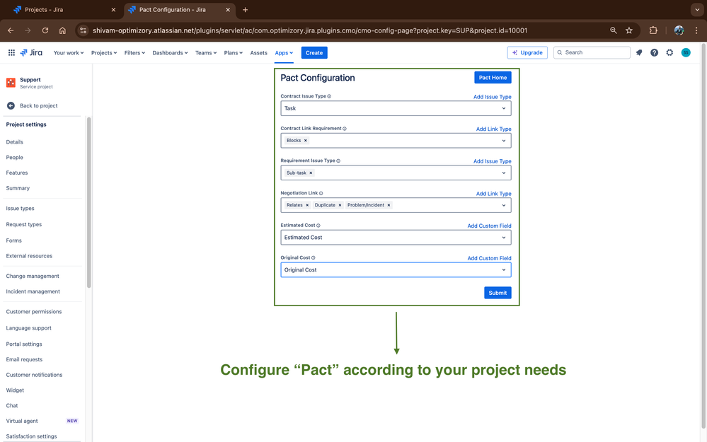

  4. Initial Configuration: On the Pact home page, click the "Configuration" button to start the initial setup process.4th.png
  5. Choose Configuration Type: During the configuration, select the type of issues you want to use as requirements, negotiation, and other custom fields you want to set up according to your project needs.Screenshot 2024-08-06 at 7.03.23 PM.png
  6. Post-Configuration: After completing the initial configuration, you can start creating and managing contracts directly within your projects.

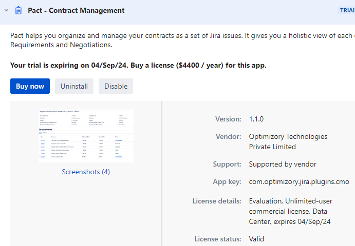

Can you show us the screen image where you are seeing that you have an active trial?
Can you confirm that you are using a Jira Server or Jira Data Center environment vs. a Jira Cloud environment? If you click on the Help button near your avatar in the menu bar of Jira, what information do you get?

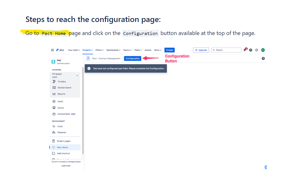

I have reviewed the documentation. It states to go to the Pact - Home Page to begin configuration, however there is no Pact - Home
Below is proof it is enabled and active. This is Jira Data Center.
The second screenshot is from their documentation
Screenshot 2024-08-05 161858.pngScreenshot 2024-08-05 161951.pngPage to go to.

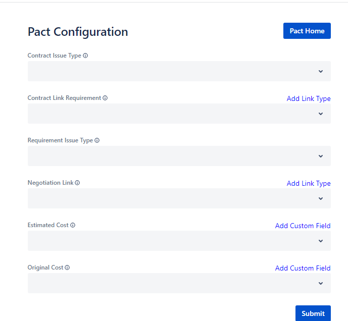

Hello @IT Group
Thank you for that additional information.
What version of Jira DC are you using?
When you click on the Configuration button what happens? I tried it on Jira DC 9.4.11. When I clicked on that button it took me to a settings screen for PACT within the Project settings.
https://baseURL/plugins/servlet/project-config/{Project-Key}/pact-settings
