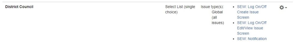

Is there custom field District Council in the system? I only get the same error as you if I change the name of the custom field to something that doesn't exist.
Rob B
August 8, 2018
Yes its a select list (cf[10405])
JohnsonHoward
August 8, 2018
Try replacing line
def cF = customFieldManager.getCustomFieldObjectByName("District Council")
with this
def cF = customFieldManager.getCustomFieldObjectsByName("District Council").first()
