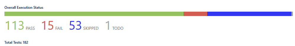

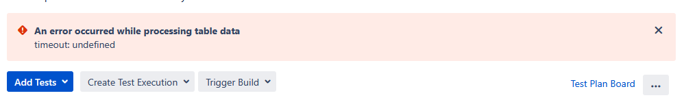

I have an issue of Type Test Plan in a Test Managment System. For this testplan, there are already 2 testexecutions.
When opening the Testplan, the Overall Execution Status is not and will not be shown. Instead an error is shown (see below). I expect to see a colored bar and a test statistic with all results from the latest issue of type Test Execution that is linked with the testplan (see also below). However, for this latest Test Execution, the colored bar with the statistic is shown, when opening the the issue of type Test Execution.
I know from other users, they can see the Overall Execution Staus and everything I expect to see. I suspect the root cause in a filter (because I was playing around with the filter when the error occurred), that can't be properly evaluated. In this case (or generally speaking everytime) I should be able to clear the filter. And unfortunately I'm not, because the occurring error prevents to show the Filter Button with the Clear Button subsequently.
I've not found any recovery, so it's in my opinion a high severe bug

Long story short: XRAY-10948

Thanks for the hint. I've contacted the XRAY and the companies service desks and got the response, that this is a known bug. According to XRAYs service desk, the XRAYs development team is currently undergoing testing and validation their fix. If everything goes smoothly during QA, it should be released by mid-September or early October.
