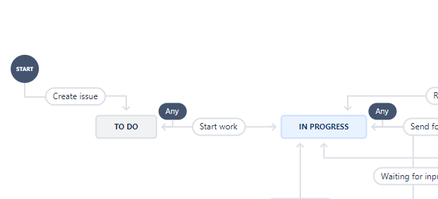

I work with a team management project in Jira - Kanban flow. But I have the same issue in company management projects as well.
I want to make Original Estimate field as mandatory (a) when creating a new issue or (b) when transitioning an issue from a TO DO to IN PROGRESS status. I can add the field in the issue layout.

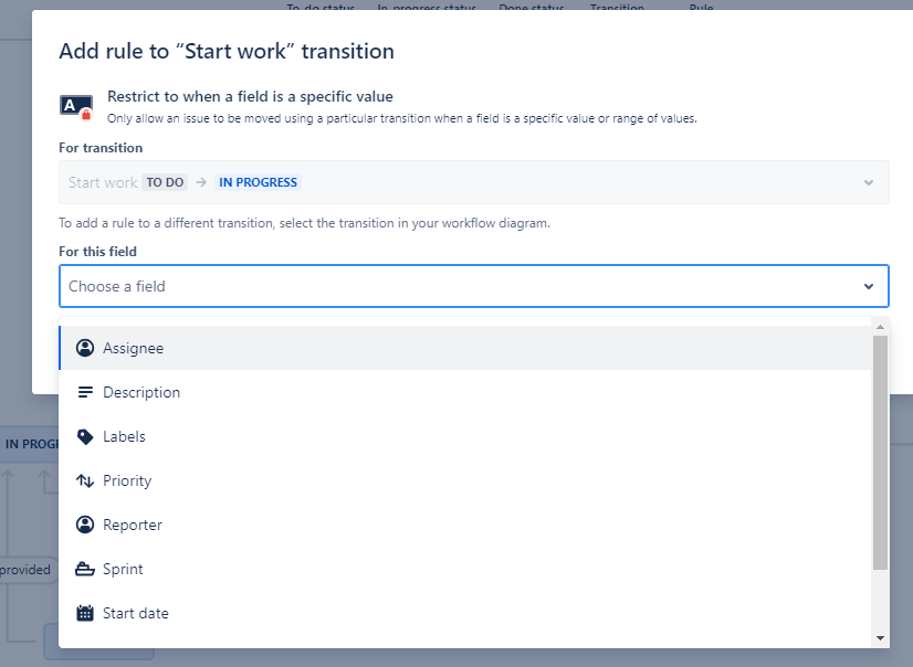

2. When I tried to create a rule for my workflow (start work transition) this field is missing again from the drop down list, but instead I see other custom created fields.

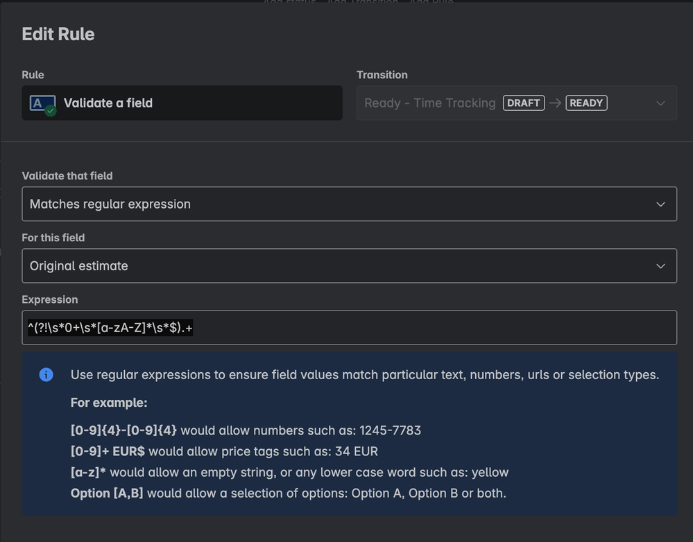

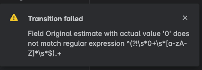

The following regex in a "Validate a field" rule worked well for me.
^(?!\s*0+\s*[a-zA-Z]*\s*$).+
Derek Preston
July 24, 2025
This was used in a company-managed project workflow.
