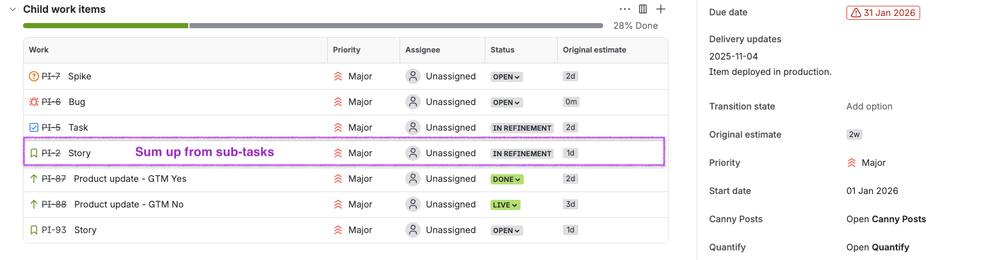

Problem:
Epic Original Estimate sum up automation is not triggering when the Story's Original Estimate is updated via another automation (sub-task to story).
Example:
Epic
-- Story 1 (original estimate = 2d) -> Manual update
-- Story 2 (original estimate = 2d) -> updated through automation
--- Sub-task 1 (original estimate = 1d) -> Manual update
--- Sub-task 2 (original estimate = 1d) -> Manual update
Result: I'd expect 4d for the epic, but it's showing 2d because it isn't picking up the values that were set automatically at the story level
Screenshot that shows the problem:
Any thoughts?

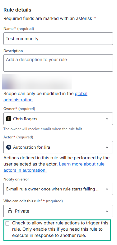

Hi @Sabrine Cardoso
In order for automation to trigger based on another action in automation, you have to check a box in the rule configuration:
It's an intentional checkbox, so you don't have automations chaining and triggering each other unless that's your intention.
Can you give that a try and see if that resolves things for you?
Sabrine Cardoso
February 5, 2026
Wonderful @Chris Rogers !!!
It worked!
Many thanks!!
