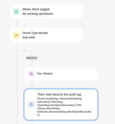

Hi @Raj Grewal,
It appears that logging time against sub-tasks does not reduce the remaining estimate of the parent item.
If you want that, you can set up an automation rule to do this for you. It should look somewhat like this:
Instead of the Log Action at the end, use an edit work item and update the Remaining Estimate field of the issue, using the following smart value for the calculation:
{{issue.Remaining Estimate.minus(worklog.timeSpentSeconds)}}
Hope this helps
