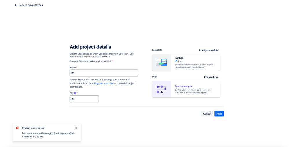

When creating a new team managed, kanban, jira board I get the error below repeatedly no matter what name I pick. I am the only user in the account, I am the org admin and should have all permissions since I am the only user and this is a personal jira instance.
ERROR is below
Project not created
For some reason the magic didn't happen. Click Create to try again.

Hi Fernando, I checked those permissions and creating team-managed projects was public. I deleted this and changed to org-admin group of which I am a part of and still no luck. I’m going to try to add a screenshot but unfortunately have been having issues because this forum is giving me errors as well.
Michael Foster
May 6, 2024
Michael Foster
May 6, 2024
More info on error. In the console I am seeing
"message": "Failed to create Project from async task: bc37073a-a2c4-48cc-82c2-3c2270cc7cf8, cause: FAILED, failing stage: project.create.flow.unscoped.product.hook ",
"status-code": 500,
"stack-trace": ""

@Fernando Eugênio da Silva Have you tried creating multiple projects? This is my second project that I am trying to create. I tried a different browser (safari) as well as incognito on chrome still with no luck and the same 500 error in the api response.

@Fernando Eugênio da Silva  By user interface only, the error codes I added above are from the network tab on the chrome dev console
May 7, 2024
@Michael Foster , thanks for your feedback!
Well, as this problem is happenning by user interface and you have 500 code error. Looks like a problem more directioned to your jira site.
I suggest you open a ticket to suporte team by here: Atlassian Support
The team will be able to help you. As community, we have no access to jira infrastructure.
