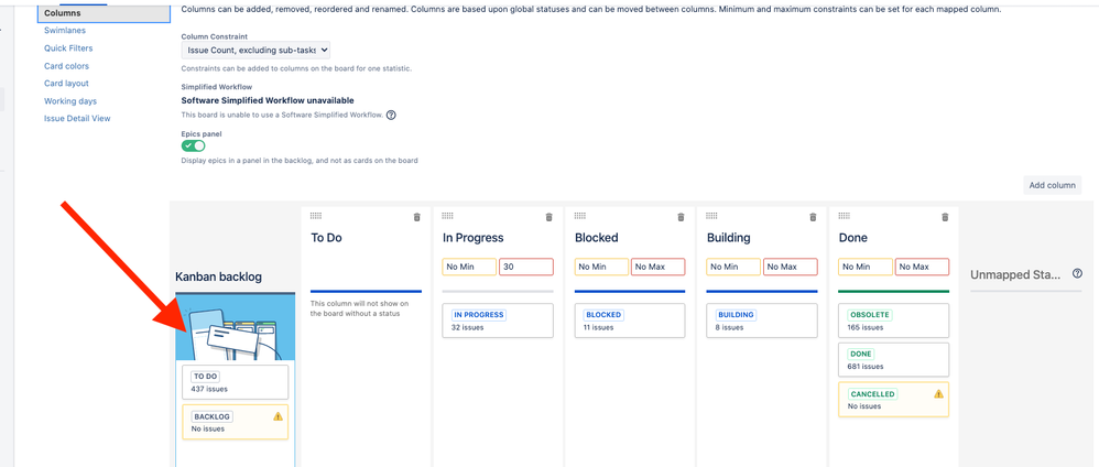

Trudy P Claspill
July 30, 2020
Hello @Thomas Hamacher
Welcome to the community.
I'm not sure if I have understood your question, but see if this helps.
If you are looking at a Kanban board with Backlog enabled, the issues that display in the Backlog screen in the Backlog list of that screen are the issues in the status that is mapped to the Backlog column for your board.

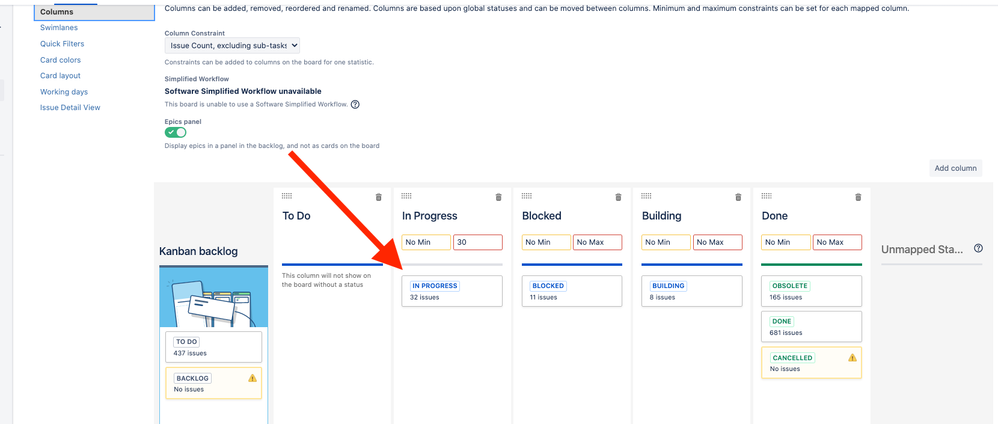

The issues that will show on the Backlog screen in the section above the Backlog list are the issues in the statuses mapped to the left-most non-empty column.
If you want issues with different statuses to appear in those sections, you have to map the statuses to those columns accordingly.
Subtasks are a little odd in that they show in the Backlog screen indented below their parent story, usually. But if the parent story is in a different status than the subtasks and in a different section of the Backlog screen, then the Subtasks will still show indented but will appear below a different story. This can be confusing. The subtask is not actually attached to that different story. I haven't found any way to address that besides keeping the Subtask and parent Story statuses the same.
