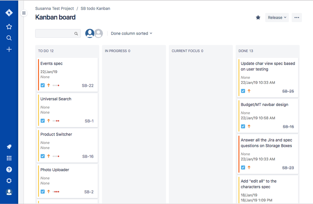

I'm on a board. How can I have resolution date be the primary sort (so if it has a resolution date it sorts by that ie the Done column) and then have rank be the secondary sort so I can still drag and drop things that don't have resolution dates yet?Screen Shot 2019-01-23 at 9.24.30 AM.png

Playing around with it a little more, I figured out how to turn off the global sort by rank, but then it turns off dragability for all columns, even those that don't have a resolutiondate. How do I modify the board filter so that it will have a primary sort of resolution_date and a secondary sort by rank?
I've tried `(resolutiondate = null or resolutiondate >= -30d) ORDER BY resolutiondate DESC, rank ASC` as the board filter, do I need to make that a project level filter?

Nope, it turns out that while it's correctly using rank as a secondary sort when I'm viewing the page (sorting all things with identical ie NULL resolution dates by rank) it's not allowing me to drag anything to a new rank position. It's giving me a toast that says "Ranking is disabled, as the Filter Query for this board is not ordered by ascending Rank. Please check your filter configuration."
But clearly it's recognizing that rank is being used as a secondary sort because it's displaying everything in the correct order that I set before this mess started.
