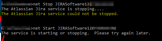

I got the same or similar issue after upgraded Jira to version 8.18.2 (using a MS-SQL DB).
This is what happens:
But in fact the windows service for Jira is shutting down.
It just takes some time.

@Sue Bridges Because I noticed, that the service is shutting down altough the message is telling that it is not I just added a delay in a first step.
and in a 2nd step I added a loop to check if the service has stopped before I start it again.
The following page was helping a lot: https://serverfault.com/questions/25081/how-do-i-restart-a-windows-service-from-a-script
Hope this helps for you too.

I had put a pause in the file, which had previously worked (10 seconds) as I had suspected the same with the Service.  However, I have upped it to 60 which worked this weekend.  Good tip about the sc query (I should have thought of that) so popped that to check stopped and started in for my log file.  If it plays up when I next upgrade I will add a loop in.  I see there is 8.19.n already!
