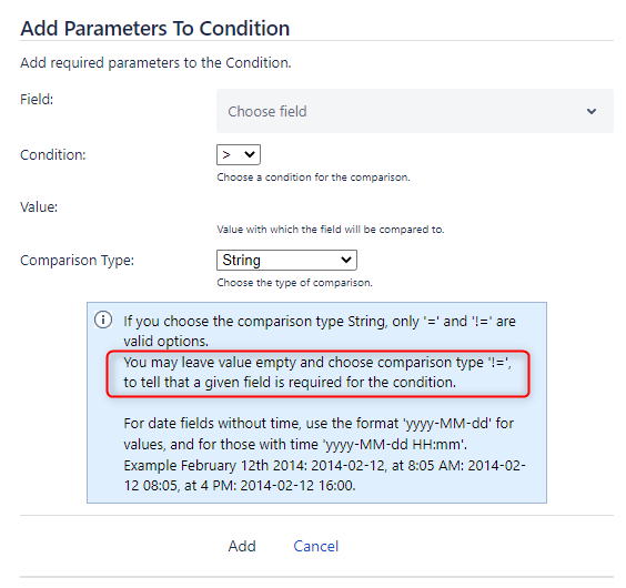

Hello,
I have a scenario where I have a multi-select field called "Feature Flags Enabled" with selection options of "INT Enabled", "STG Enabled", "PROD Enabled". What I am looking to do is to prevent the status of changing to "QA" without the INT Enabled option being checked.
I feel like this is either a Validator or Condition on the transition. I found one that allows for the value to be looked at against an OptionID but could not figure out how to change the OptionID to something other than NULL.
Any ideas for how to accomplish this? I am unable to use any paid plugin apps to accomplish this so looking for something out of the box or free.
Thanks!

Hi @Katie Pickrell
I think the "Value Field" Condition is what you're looking for. 2023-03-01_12h20_09.png
Hope this helps!
Kel
Katie Pickrell
March 1, 2023
Hi Kel - Yes this is what I was working on. I actually think I was getting tripped up on the fact that the Value field didn't look like I could type anything in because it's not a text box but I see that I can!
Thank you for helping to point me in the right direction!
