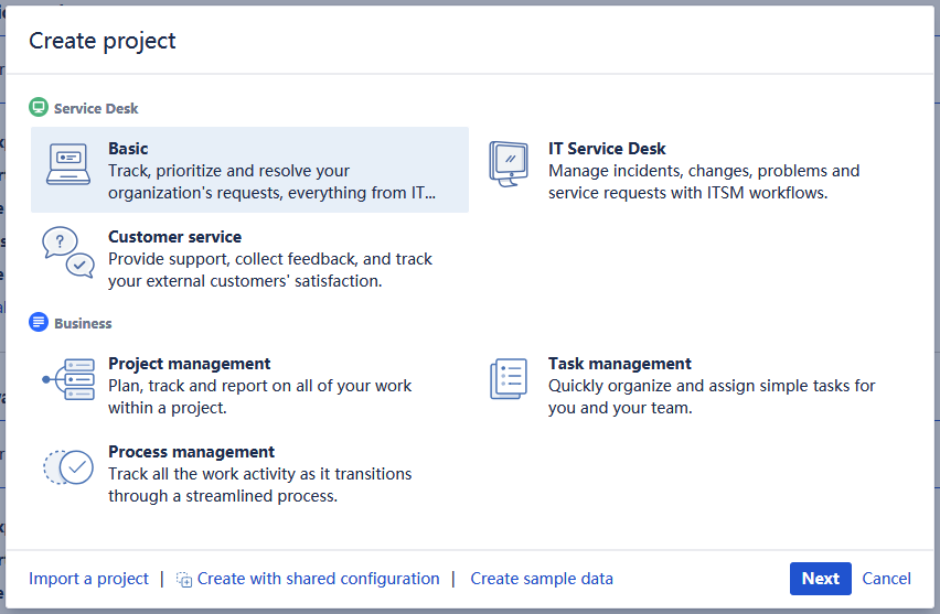

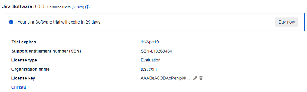

Hi,

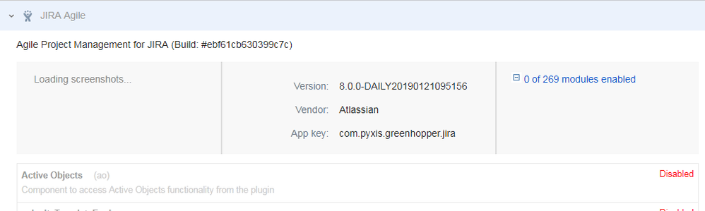

I'm running jira software 8.0 under an evaluation license for server on windows 7,  There WAS an option to create software project the other day,then all of a sudden I can find it any more, and under "Manage apps" section, I find that all the 269 modules of JIRA Agile are disabled, and I can find any buttons/links to enable it.
Snipaste_2019-03-13_17-00-24.pngSnipaste_2019-03-13_16-57-52.pngSnipaste_2019-03-13_16-59-16.png
I appreciate any help to trouble-shoot this problem, Thanks in advance!

3. I found something in one of the log files:
___ FAILED PLUGIN REPORT _____________________
1 plugin failed to load during JIRA startup.
'com.pyxis.greenhopper.jira' - 'JIRA Agile' failed to load.
Error creating bean with name 'greenhopper-launcher': Invocation of init method failed; nested exception is com.thoughtworks.xstream.io.StreamException: : only whitespace content allowed before start tag and not [ (position: START_DOCUMENT seen [... @1:1)
It was loaded from C:\Program Files\Atlassian\Application Data\JIRA\plugins\installed-plugins\jira-greenhopper-plugin-8.0.0-DAILY20190121095156.jar
Have no idea what that means...
