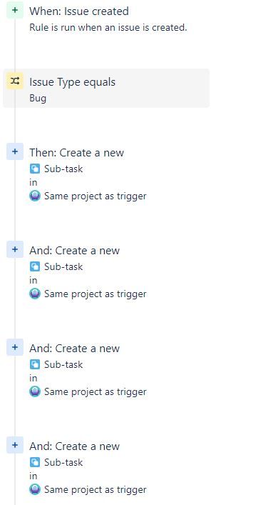

Hi,
right now I created this automation rule:
so whenever I create a new Issue of type Bug, there are also 4 subtask created.
Now, I only want to be able to move Subtask 3 into "in Progress" once Subtask 1 and Subtask 2 are set on "Done". How can I do this inside of "Automation"?

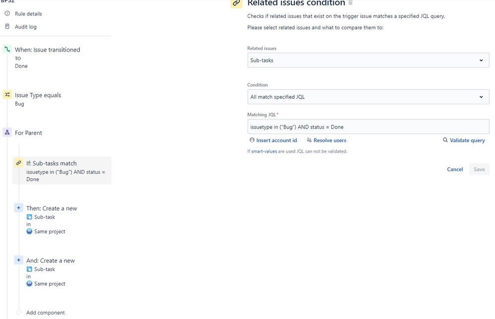

thrilos07
March 5, 2021
So I gave up trying to block sub-tasks from moving while others are not done. Right now I am trying a workaround, where if 2 sub-tasks are set to done another 2 subtasks are getting created inside of the same issue:
But this does not work also :). Not sure what I am not doing right.
Sam Harding
March 7, 2021
Hi @thrilos07
It seems like there might be a problem with the issue type checks here. Can you confirm what the audit log is saying when the rule executes? If I am understanding your situation correctly, you are wanting to fire the rule off when a sub-task of a bug is transitioned to "Done", and then check if the parent bug's sub-tasks are all Done as well. With you current rule, the first check will be checking the triggering issue's type is bug. However, the triggering issue type would be a sub-task, not a bug, so this should fail. The same goes for the check in the branch's condition as well.
Can you try changing the first condition from "Issue type equals Bug" to a Related Issues Condition, and in that check the Parent matches JQL "issuetype in ("Bug")". Then remove that part of the branch's condition (just set the branch's condition JQL to "status = Done").
Hope this helps,
Sam

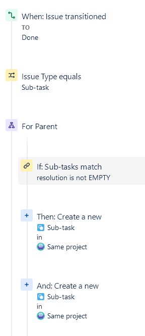

Daniel Ebers
March 8, 2021
Hi @thrilos07
according to your requirement:
I was able to build a rule in my Jira Cloud which meets your requirement.
It is tested and it works - probably there is a more elegant way, you could check.
Most parts are easy, for the "If: Sub-tasks match" "resolution is not EMPTY" part the Condition is "All match specified JQL".
However, I am not sure if this is the whole picture as in this thread were other things to be discussed, also - alongside with the thread:
https://community.atlassian.com/t5/Jira-questions/Create-Subtask-after-all-Subtasks-are-done/qaq-p/1630389
So - please check, overall, if everything is understood correctly and complete.
Cheers,
Daniel
Like # people like this
