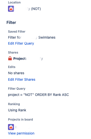

I created a brand new board to see if there was something amiss with the existing one but that exhibits the same problem.
Here are the board settings...
There's no filter applied to the backlog view...

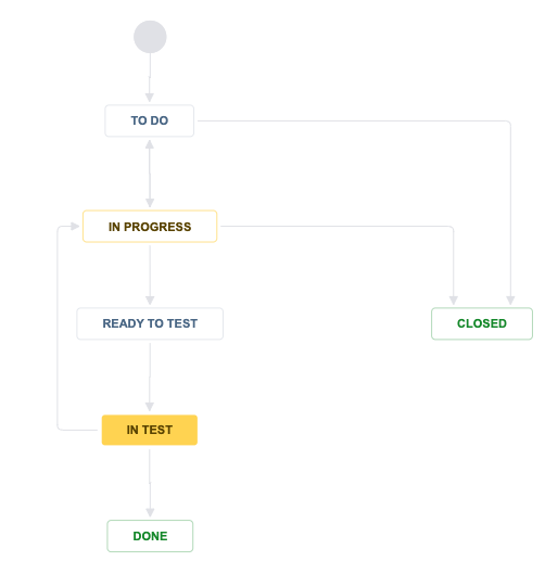

The workflow for the bug / story / task is...

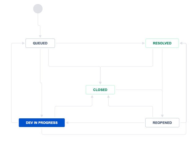

Whereas the workflow for the Support ticket - the issue type not showing - is as follows. This is the read-only Jira (system) workflow.
