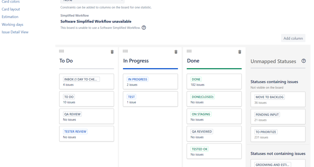

Untitled.pngThe status INBOX (1 day to check) contains 4 issues, and it is mapped to the column, but the issues don't appear on the board
Yuliia Zhyliaieva
August 19, 2020
Seems like issues from a Kanban board do not appear here. I experimented with other unmapped statuses, and one issue popped up on the board - and it was the one of 213 that had a sprint field updated by mistake
