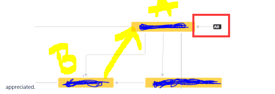

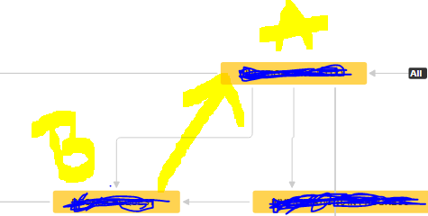

Currently in workflow user has to do transition from A to B. But, user had made a Reverse  transition without having a REVERSE Transition in workflow. Client has questioned how come it's possible to do it without adding a reverse transition from B to A. Attached screenshot for your reference.
Can someone pls let me know Urgently how the user has made Reverse Transition? Your help would much appreciated.snipp.PNG

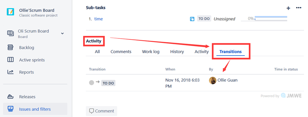

Hi @Roja Gurram ,
Can you find which user performed this action in activity --> transition?

Hi Ollie Guan.
1) Can you find which user performed this action in activity --> transition? -
  We found the exact user.

Ollie Guan
July 13, 2020
Hi @Roja Gurram ,
The problem should be here: allow all transitions.
Please adjust the configuration as you needed.

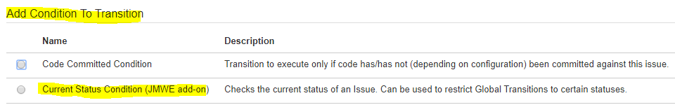

Roja Gurram
July 13, 2020
Hi Ollie Guan,
Thanks a lot for the clarification.
1) Please adjust the configuration as you needed. -
Ok, Understood in this  case if i don't want to make REVERSE Transition from B to A then do i need to Add a CONDITION  for ALL Transition selecting the condition as per the screenshot attached below. In that whatever the STATUSES we don't want to make reverse transition do we need to check the box?
Please let me know the right direction to get this issue resolved.

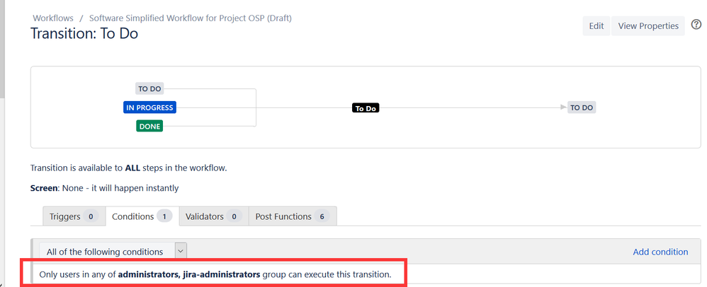

Ollie Guan
July 13, 2020
It should not be necessary unless you have previously configured reverse transitions for all processes.
It is recommended that you delete the "All" transitions in the snapshot above.
You can also add some conditions, for example: Only users in any of administrators, jira-administrators group can execute this transition.
Roja Gurram
July 13, 2020
HI Ollie Guan,
Thanks again for coming back.
1) It should not be necessary unless you have previously configured reverse transitions for all processes. -
Ok, it means that keeping the ALL TRANSITION is the reverse transitions for all statuses?
2) It is recommended that you delete the "All" transitions in the snapshot above. -
The one which you have highlighted the ALL TRANSITION in my initial snapshot do you want me to delete it ? Instead of removing the All transition we can do with the screenshots i have attached by using the JMWE Addon i think.

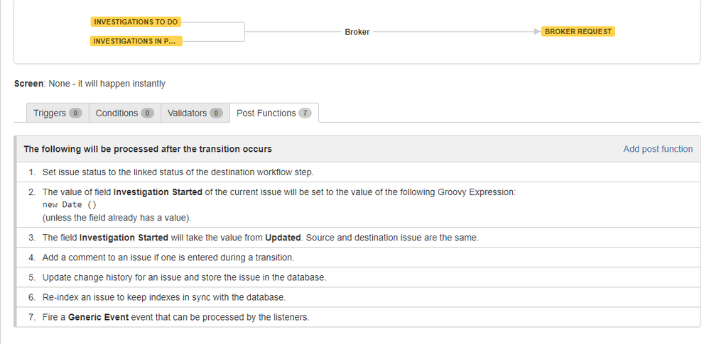

Radhika Vijji _Innovalog_
July 13, 2020
Hi Roja,
Does it still happen? Do you have any post-functions on the transition that might send the issue back to the previous status? Please check the list of post-functions on the transition from A to B.
Regards,
Radhika
Roja Gurram
July 13, 2020
Hi Radhika,
I have attached below snapshot which list the post functions added in the transition from A to B.
Kindly suggest me accordingly so, that i need to clarify to the client.
