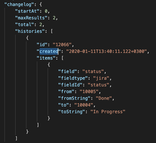

Issue status history data is available via Jira Rest API. It provides the exact status transition date and time. It returns json as below, then you need to extract and calculate the date differences.

However, the API overwrites the category's update date data, always leaving the most recent and not a history like I need.
How can I capture the history of dates that got changed using the API?

You can try the changelog api with pagination.

Unfortunately, Jira does not give this information directly.
If you want to do this yourself, you will have to use make a REST call for each issue to get its history and traverse through issue history to do the calculation yourself.
