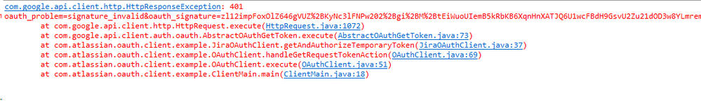

Hi guys,
I dig up an old topic, but today I'm facing exactly the same issue, after having followed this topic: https://developer.atlassian.com/server/jira/platform/oauth/
The symptom is the same: POST fails with 401 error as per the sample provided in the link of above, when I execute a simple requestToken.
But changing it to GET works, or a kind of as it returns null string:Untitled1.png
I also tried to set up useBodyEncodingForURI to false as described here, but it changed nothing.
What can be the root cause for that ?
Thanks for your help
R.
