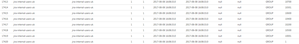

After running your SQL, I can see that the same groups are listed multiple times. Often 2 or 3 times but in some cases as many as 19 times. below is an example or a group that has 8 entries.
What could be causing this behaviour?

It looks like you have at least 8 user directories in Jira (1 internal, 7 external).  You might have more, I can't say for sure from just that one screenshot, but you have at least that many.
If you added the same user directory to Jira 7 times, and it is syncing the same user groups, each directory have their own groups.   Since 7 * 141 =987 I would venture a guess that this accounts for the vast majority of all the groups that are being counted in the database.
I'm not sure why you would have a configuration like this, but it is possible.  Perhaps each user directory is using a slightly different ldap filter in order to limit the number of users/groups returned by that specific user directory.

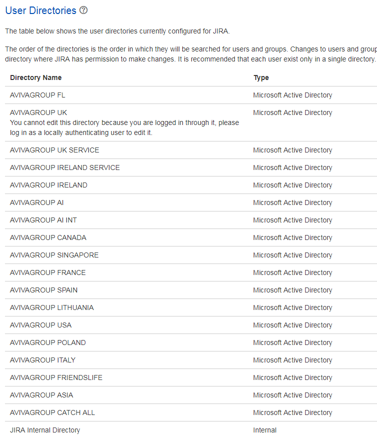

I was going to respond to say we have a number of user directories that point to different OU's in Active Directory.
Is this a factor?
