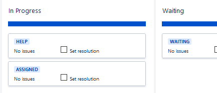

I have my Kanban workflow(Simplified) with an added column(Waiting) and a couple extra statuses in 'In Progress'.

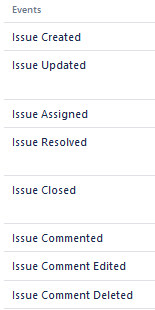

I see the usual 'Notifications'
My Kanban Columns and Status
1)  How do I let my boss know when an issue is 'Waiting'  or 'Help' or a different status?
2)  Which notification covers 'In Progress' and the columns?
I.E. I don't think my boss cares if something get's moved to 'To Do' or 'In Progress'  but he does if it's sitting in 'Waiting.
Is there anyway to match the issues up closer to the Columns/Status?
Thank you!

There is not a built in notification event that is for when a card changes columns or changes to a specific status.
Take a look at this article and see if it provides enough information for you to create an email notification as part of specific status changes.
https://support.atlassian.com/jira-cloud-administration/docs/configure-email-notifications-for-a-custom-event/

Columns on a board are just a visual representation of groupings of issue statuses. There is not a data element stored in the issue that indicates what column it is in on a board, as an issue can be shown on many boards all with different columns.
