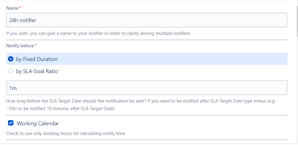

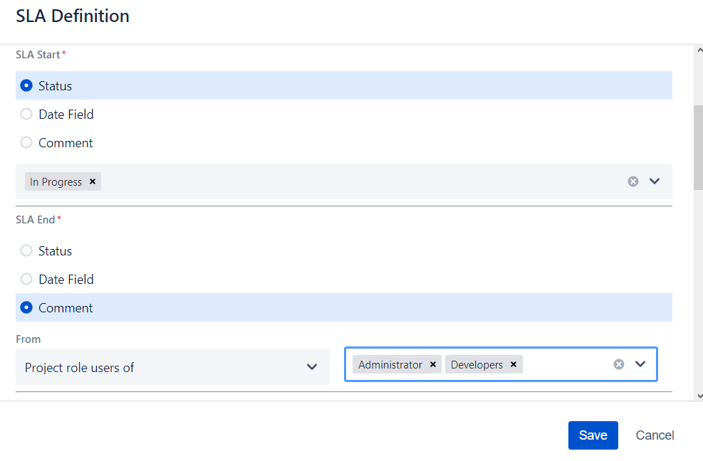

Hi @Josh Allen ,
You can also use an SLA to be notified since it captured the necessary conditions better than Automation and you don't need to spend your free Automation executions for this.
You can use Time to SLA to get notified via Slack as well as email.
Check this configuration out:
SLa start.pngYou can set your SLA Goal as you wish and add a notifier at the 24hour mark. (SLA Goal is 24 hours in this example)
notifier.pngYou can combine other features of Time to SLA such as detailed reports, global notifier, and recurring notifications with this configuration to easily manage your idle tasks.
Let me know if you have any questions.
Cheers,
Gökçe

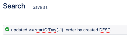

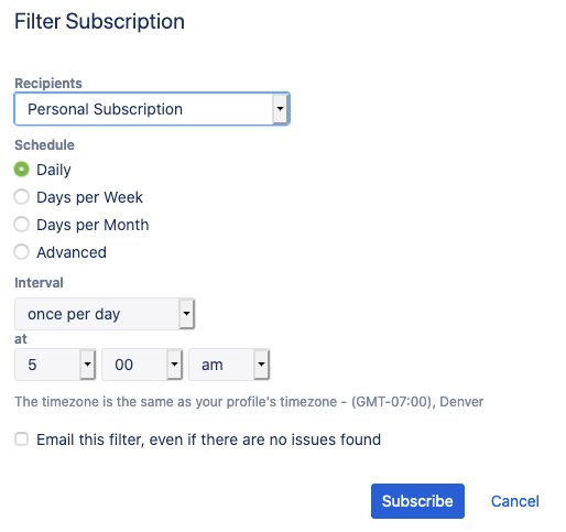

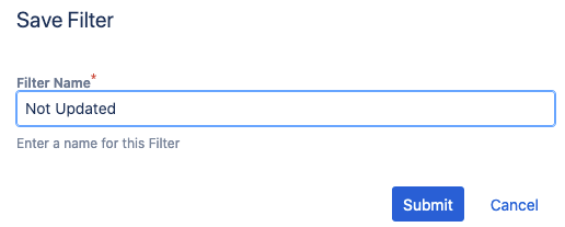

Dan Wilson
September 4, 2020
@Josh Allen
Another approach would be to use saved filters and subscriptions.
1. Define the filter you need to show the tasks to be reported on
2. Save It
3. Browse to the list of filters "Filters --> View All filters" and locate your saved filter
4. Click on the eclipse menu and select manage subscriptions --> add subscription button on the next screen
5. Set the recipients, frequency, and time you would like to be notified each day.
6. Click Subscribe.
This also allows for others to subscribe to the same filter on a frequency they chose.
You can update the saved filter if your need change later
This doesn't take automation cycles if the number available is a concern for you.
