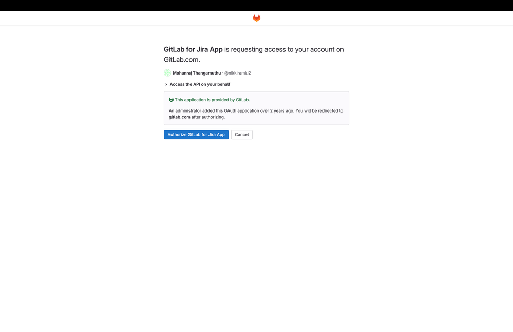

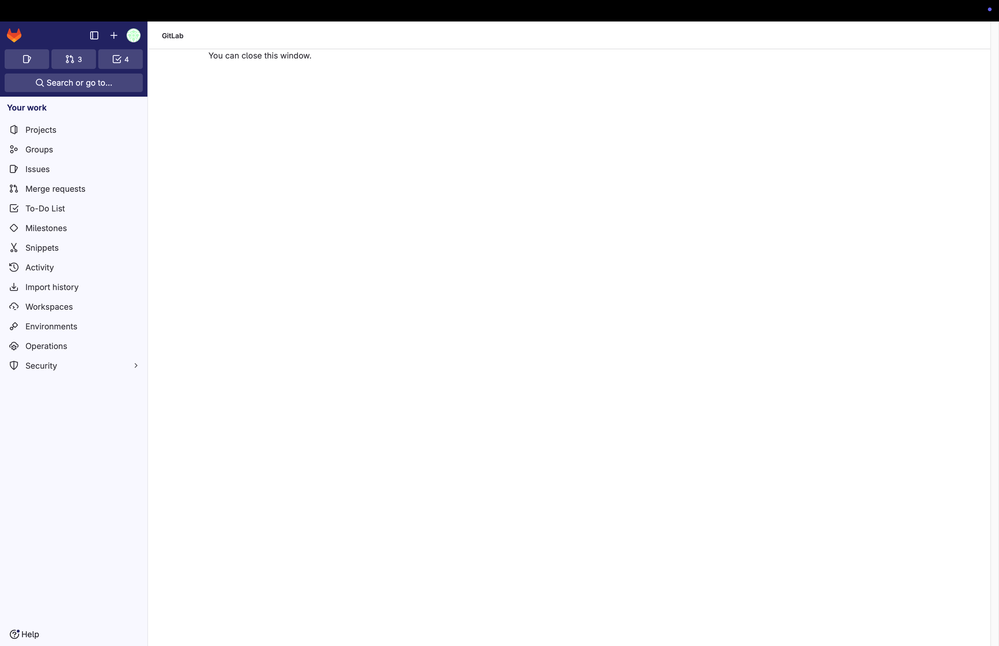

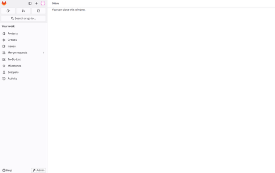

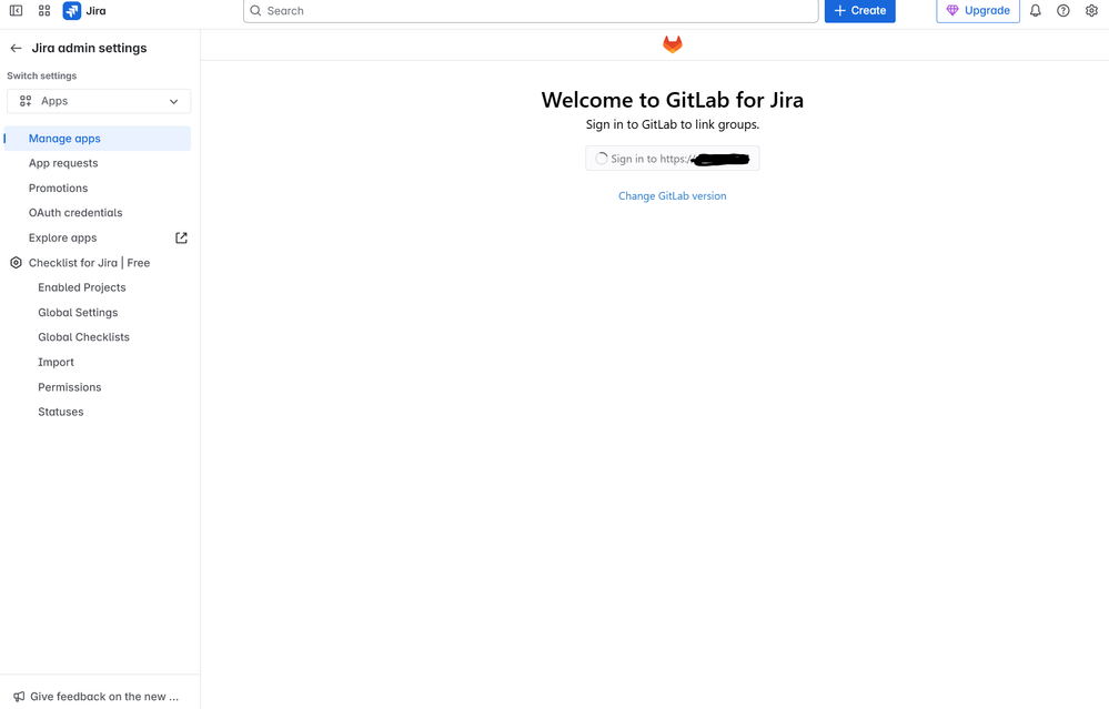

After this I should be ready to install the Gitlab for Jira Cloud inside Jira and configure everything. So I select Gitlab self-managed and enter our instance domain. After this I click on sign in and authorize the application. Then i get redirected to this page;

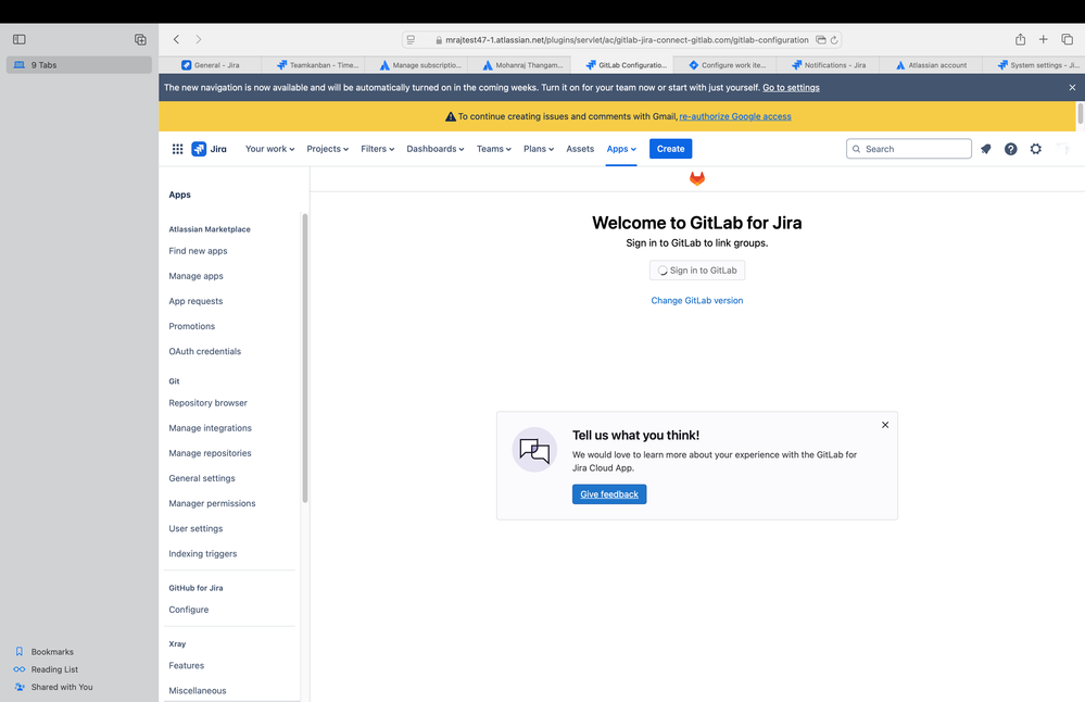

When I close this or just go back to the Jira page where I was configuring the Gitlab for Jira App I can only see the button with a spinning animation and just hangs there and does nothing, not even an error message;

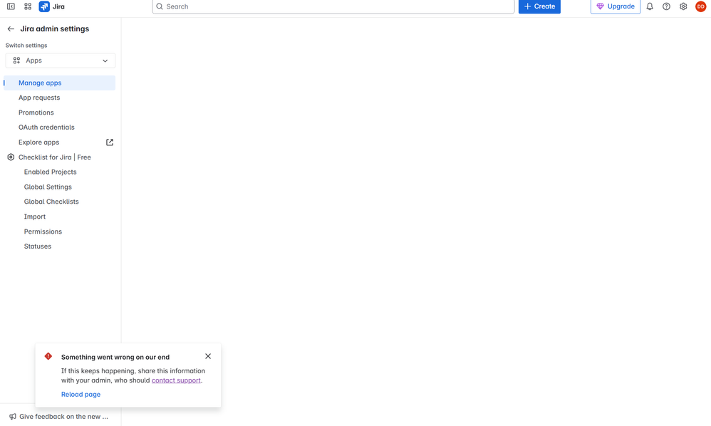

We didn't get it to work this way. We ugraded our Gitlab instance to 17.11 so that we can manually install via de app_descriptor file that is hosted on our instance. We managed to do that only this is now the result.
