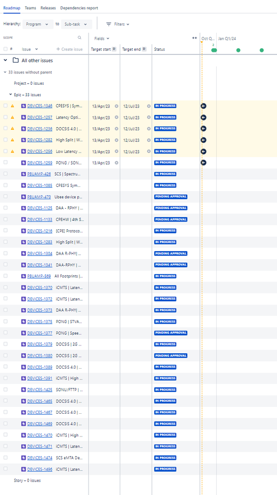

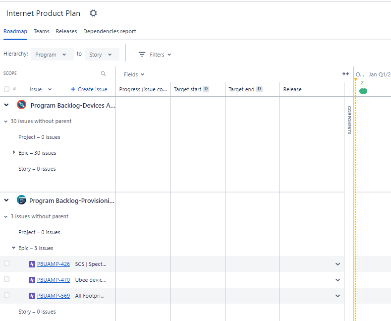

Can you show us a portion of your roadmap/plan that illustrates the problem?

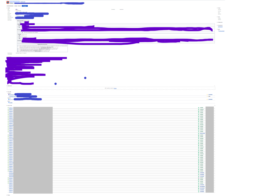

And can you show us the details of an Epic that also is included in the problematic issues?
The parent/child relationship display leverages the Parent field in the child issues to identify the parent issue. If you have used the generic issue linking functionality instead, then Jira will not recognize that as a parent/child relationship.

Do the missing child issues of the Epics show up in the plan under the "33 issues without parent"?
