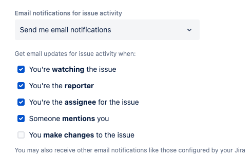

The first thing to check is that the emails are not going to your junk/spam folder and that you don't have any rules set up in your email client that are automatically deleting them or pushing them to another folder.
The next thing to check is your Personal Settings to ensure you have not disabled email at that point.
Click on your avatar and select Personal Settings and look at these settings:
The next step is to contact your Jira Administrators to confirm that the notifications for the project are configured in such a way that Jira should be trying to send you emails. The Jira Administrators can use the Notification Helper to check that.
If all that checks out, then your Jira Administrators can open a support case with Atlassian Support to find out if your email addresses has gotten black listed, and get it off the black list if that is the case.

My settings are exactly like the ones on the picture that you have sent.
