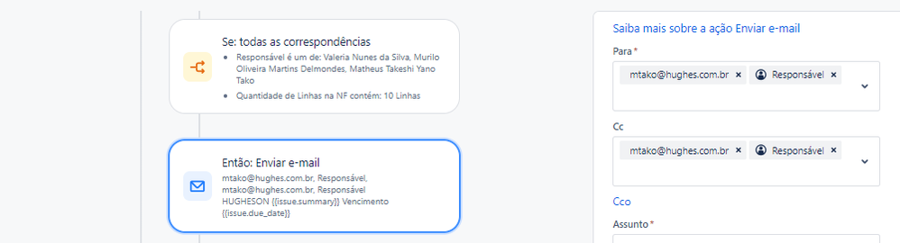

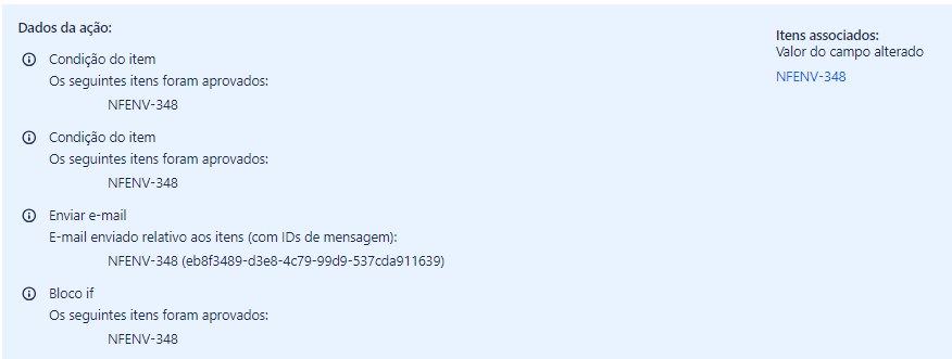

Here are my audit log from this specific rule that I'm testing. Which it says that "E-mail sent to issue's relatives" - So I'm assuming that would be a successful e-mail sent by the automation, but I've checked every folder in my e-mail account and I can't seem to find this e-mail.

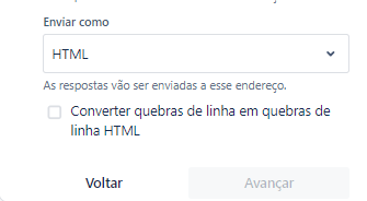

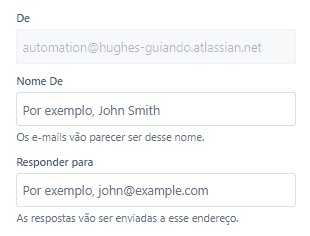

And following below is a evidence of how my send email component is configured. The only thing I've changed is I uncheck the box of "Convert line break to HTML line break":
Since I've tested other rules and it worked, it seems the problem is with this rule. I can't see to find a reason on why is not working.

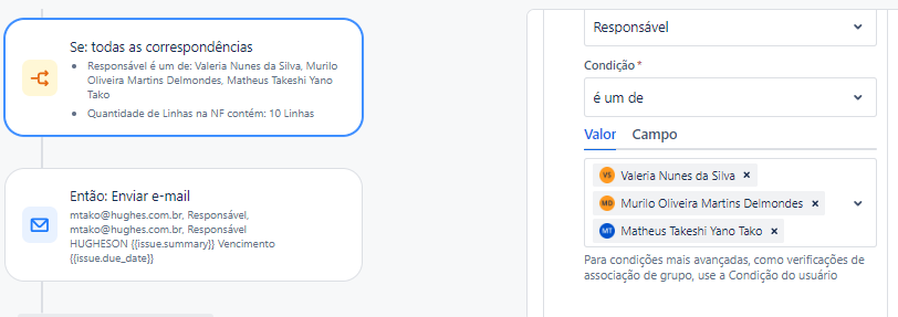

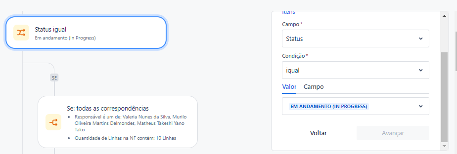

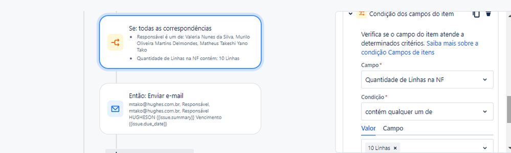

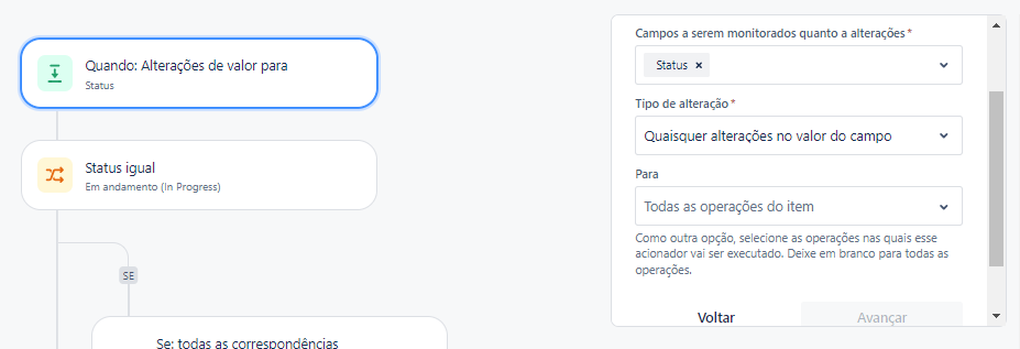

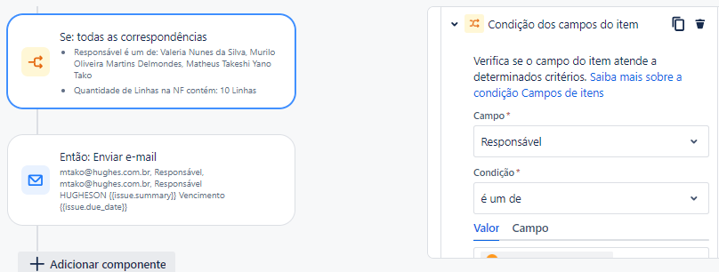

My automation has almost 65 components. So I've created a smaller version to test it out. Yesterday it didn't work out as I wanted.
So Here is the entire automation:
Entire Automation 1.pngEntire Automation 2.pngEntire Automation 3.pngEntire Automation 4.pngEntire Automation 5.pngEntire Automation 6.png
the subject of the e-mail is: HUGHESON {{issue.summary}} Vencimento {{issue.due_date}}

This query creates a table from our issue. This Query is not blocking the e-mail. I've tested this many time and even had the help from other Question I posted in the community. Anyway, This is the entire rule. I can't figure out why I can't receive the e-mail. Which in test I've down a week ago I've received emails.
If you need more information, feel free to ask me.
Best Regards, Matheus.

I think I must have changed some configuration. Since I already look in my outlook account and I didn't block the jira e-mail.
Would you know which configuration I need to change?
Best Regards,
Matheus.
Trudy P Claspill
January 22, 2024
Hello Matheus,
Do I understanding correctly that you are not receiving any notifications from this one project? Neither notifications from Automation Rules nor notifications based on the notifications configured for the project?
If so, please confirm that you have access to the contents of the project. Are you able to access the project and see the issues in it?
In the tags you added to the post you indicated that you are using Jira Service Management. Does this problem concern a Jira Service Management project? If so, have you been granted an agent license for the Jira Service Management project? And are you a Service Team Member (an agent) for this specific project?
