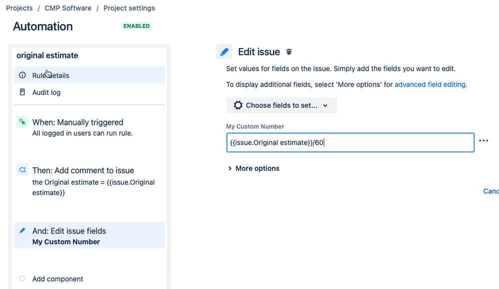

hi @Filip Novák , this quick test worked for me. Note, I used "60" to convert the OE from seconds to minutes.

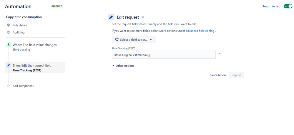

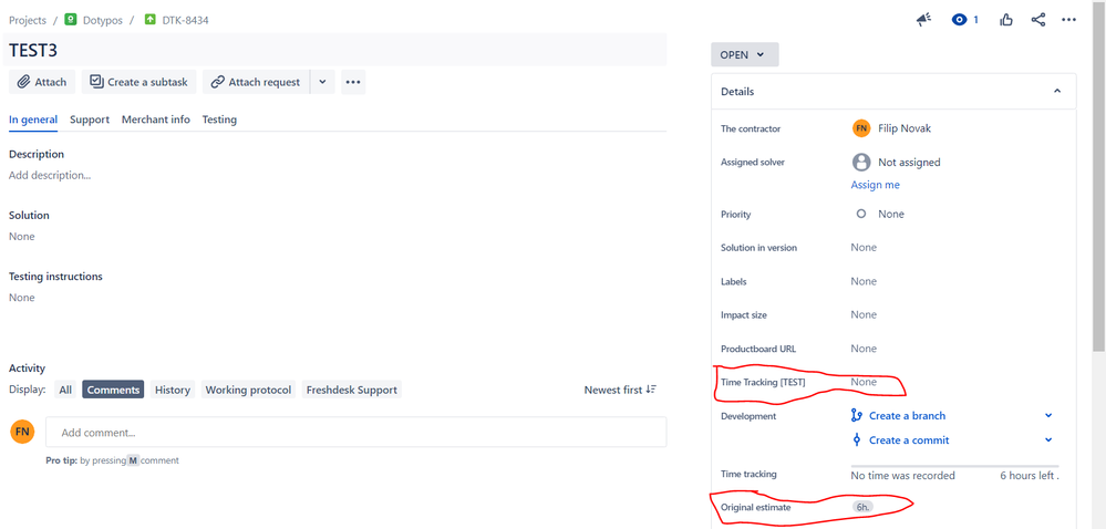

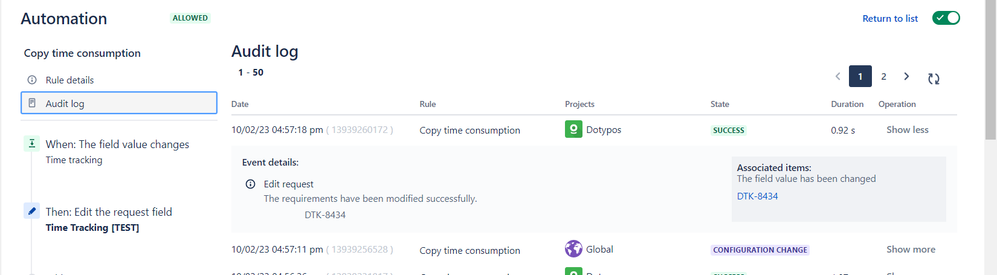

Filip Novák
February 10, 2023
@Jack Brickey Thank you, but it doesn't work still.
I do receive success, but the fields does not copy to each other.

I think the issue is with your malformed smart value. Move the"/60" outside of the braces.
{{issue.Original estimate}}/60
The only other difference that I see is that it appears you have a global rule while mine is project specific but that shouldn't matter.
