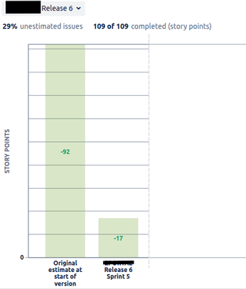

Not all of my Sprints are showing in my Release burndown Report
Tina Strother
February 2, 2026
I am attempting to run the Release Burndown Report. I have 5 sprints within this Release. When running the report, it shows the correct start and end dates of 14/Oct/25, 12/Jan/26. However, the report is only showing the original estimate at start of version and Sprint 5. There is no information being provided for Sprints 1-4.

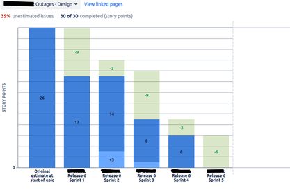

According to this page, I should be able to see the information needed, if nothing more than everything showing as completed at this time. I am looking to find similar information that is provided on the Epic Burndown Report ie:
  • Story points at the start of the Sprint
  • Points added to Epic
  • Points completed within the Sprint
  • Points remaining at end of Sprint
I have ensured all my issues have the fix/version, Sprints were opened/closed, all tasks are in done status, all issues have story points. I am unsure of what may be causing the issue of only showing one Sprint in the Release Burndown Report.
Any assistance would be greatly appreciated!
Thank you in advance,
Tina

*Something I just noticed, I went into my jira plans to check the number of stories which rolled. Only sprint 5 is showing in my plans. It seems as though I have lost sprint 1-4 somehow. If I use a jql, I can search for those stories/tasks within those sprints and find all my issues. So my issue is not that I am using the release burndown incorrectly, but jira is not seeing my sprints. Any thoughts on this?

No, I apologize for any confusion. I can make the JQL inquiring sprint 1, 2, 3, 4 and/or 5 and see the issues within the inquired sprint(s), whether I have one or more sprints in the JQL. I have no problem seeing the issues or the sprints except in Jira Plans and the Release Burndown chart.
