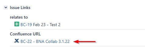

I have an automation that creates a confluence page when an issue is assigned and creates  a Confluence URL link to that page in the Jira issue links section. like below.
The problem I'm having.  I can't find a method to access the confluence url after it is created.  All of the methods for linked issues cant see the confluence URL.

Links to a Confluence page are not issue links but remote links. They are not accessed the same way.
JMWE offers a "simplified API" for accessing the remote links of an issue:
issue.getRemoteLinks("APPNAME")
In your case, the APPNAM is likely to be "confluence", so:
issue.getRemoteLinks("confluence")
 Then, to get the first link's URL:
issue.getRemoteLinks("confluence")?.first().url

That works!
Thanks!  I've been working with Groovy for a week and this api for a few days so this is a big help!
