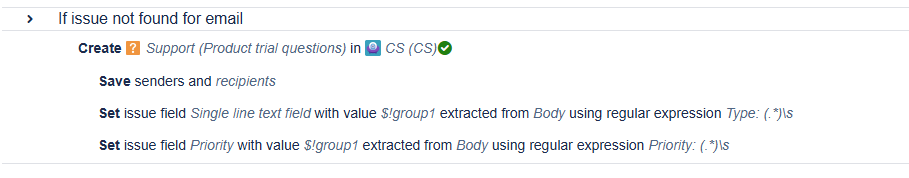

The email address needs to be linked up to the Email This Issue mail handler (link in the documentation I provided), which then creates the Jira issue according to the rules you set up - which should include the several "Set filed" actions to extract the information from the email body and add them to the required field.

In the app's mail handler you can use regular expressions to retrieve content from the email and set field values accordingly when creating an issue or updating it via email: Email This Issue - Mail handler - Set issue fields

I was not able to get this to work on a local install.
Is there something that I am doing wrong.

Hi @chris cawley,
Can you open a support ticket with us?
It would help us get a jump start if you included the following:
To just test the mail handler without linking it up with an actual connection, you can use the "Test handler" button, where you need to upload an email in .eml format.
