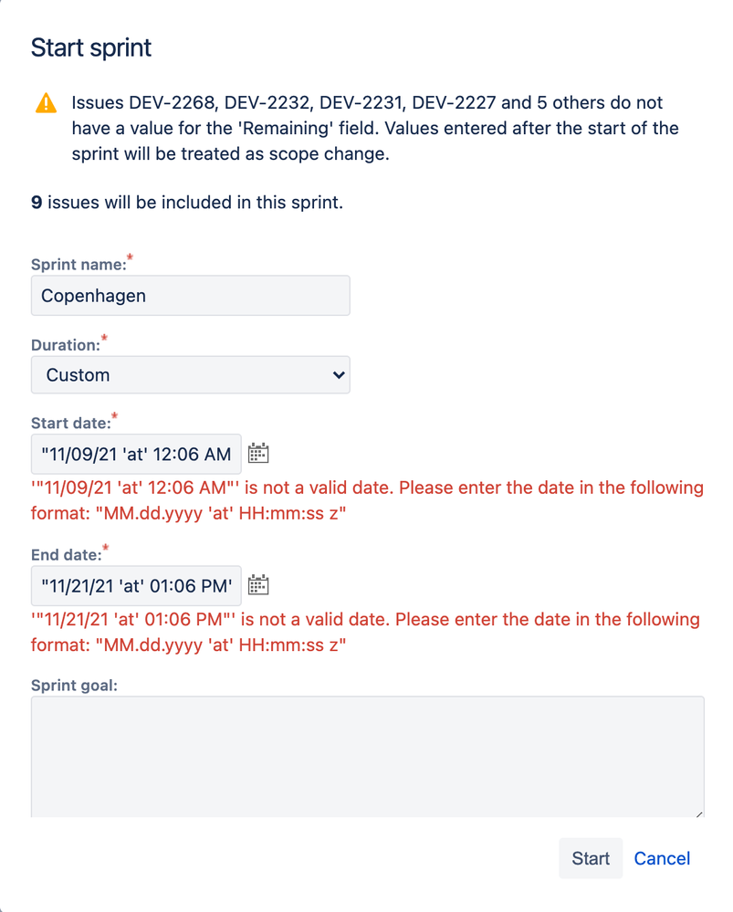

We're not able to start the sprint due to the start date and end date error. We're typing it in the suggested format but still, it doesn't work. Please assist in this regard.

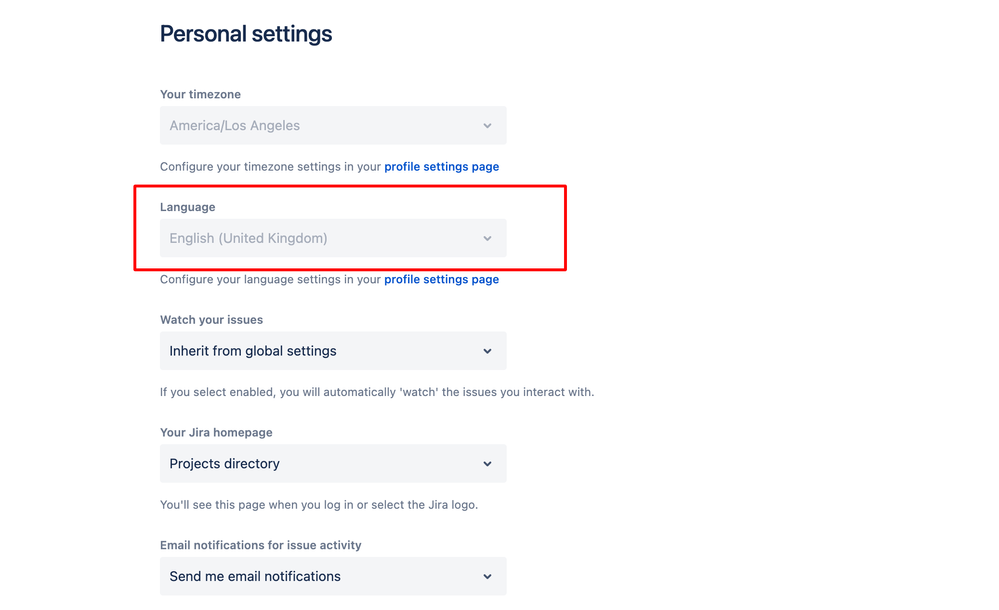

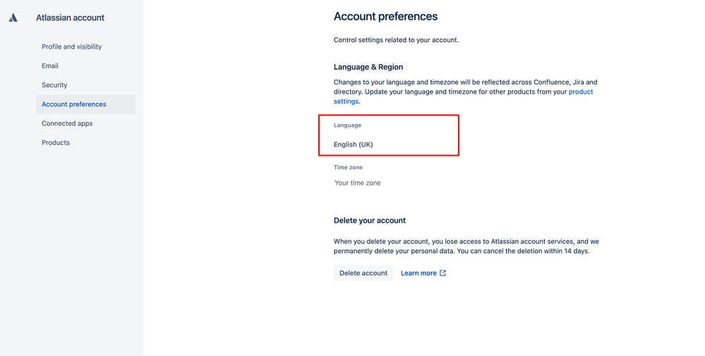

@Trudy P Claspill The language is the same at the global level & in a personal setting, Here is the screenshot of the language.

Can you share a screenshot of what you are doing?

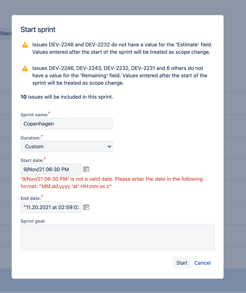

i have set the format reflecting in the error message but its throwing same error
This may be related to the internationalization issues I mentioned in my response, when the language for Jira globally and the language preference of the user do not match.

Also, try the suggested format without the double quotes on the outside and with single quotes around the word "at".
11.20.2021 'at' 02:59:00 00
