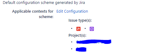

Prashant Sinha January 31, 2019
Thanks Nic for your reply. I do cross check the share setting and it was there but still we are getting the same error. Refer the attached snapshotCapture.PNG

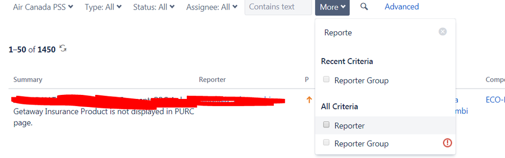

Ok, let's try this a different way.
Go to an issue in the Air Canada PSS project and edit it (with the edit button, not in-line), so that you have all the editable fields available.  There's no need to change anything for this, we just need to get to a function.
To the top right, there should be a configure button, usually used for showing and hiding fields for the current user's convenience, but there's another option on it called "where's my field?"  Use that, and ask it about "Reporter Group".  It will pop up a list of reasons why the field is not on the edit screen, with links for admins to fix them.  Some of the reasons on there also block fields from being available in search.
