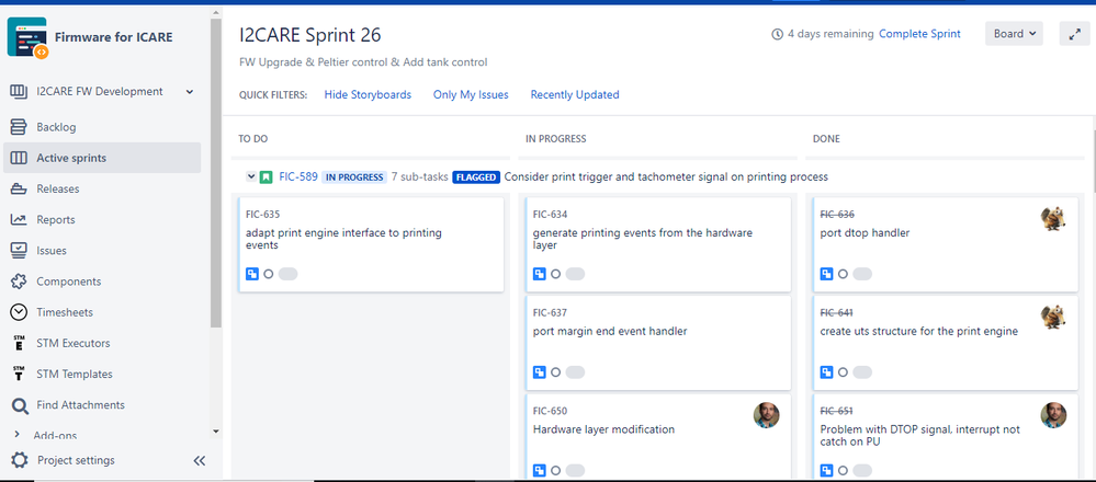

njain2@markem-imaje.com
November 30, 2020
See above in the TO DO, IN PROGRESS, DONE column, there are gray button, I am talking about that story point.
Regards,
Neeta Jain
Walter Buggenhout
November 30, 2020
Hi njain2@markem-imaje.com,
Thanks for sharing the screenshot! That is not a dashboard, but a scrum board - which is why I wanted to make sure what you meant initially.
My guess is that you put your estimates on stories. At the same time you have swimlanes on stories, which is why we're seeing subtasks as cards. To see the actual story points on stories, update the swimlanes to none.
To do so, go to Board settings > swimlanes and update the selected option to none.
An additional thing you may check - while you are in board configuration anyway - is whether the estimation statistic for your board is set to story points. You can validate that that in Board settings > Estimation.
November 30, 2020
Hi Walter,
Thank you so much for your quick response.
I have made the changes as you mentioned, and now story points are visible on the scrum board.
I have also configured "Story Points " for those projects, now the issue is resolved.
