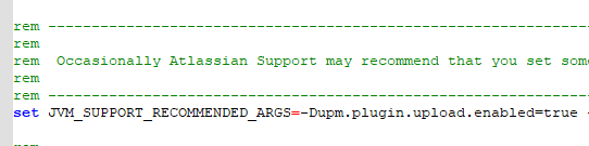

Hi, I also tried on Windows and for me works, the button is displayed. The argument looks like in the pictureScreenshot 2024-09-01 221608up.png

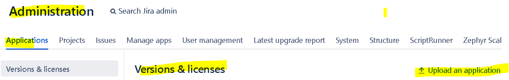

Make sure the user with which you are logged in has the system administrator global permission.
If you are using Jira Service Management you can upload from Versions & licenses, like below
