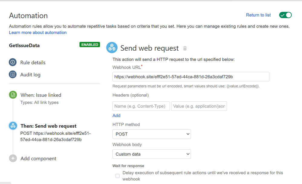

We are trying to call a webhook on "Issue Linked" event using Automation available in Project Settings tab.

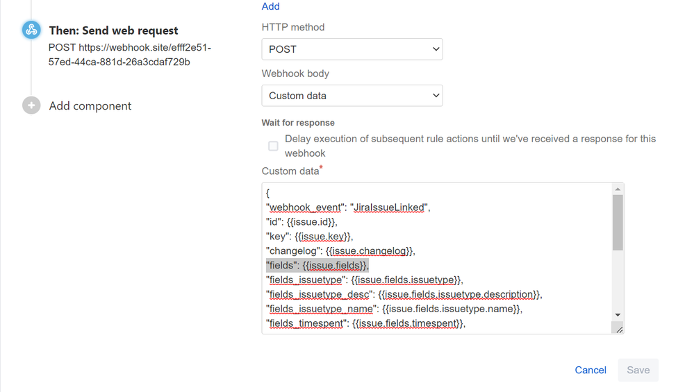

We are not able to see the fields value when we to send the value to webhook.
I am attaching the screenshot of Automation rule and the custom data we are trying to send to webhook.

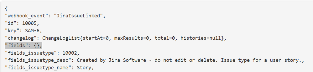

I am attaching the screenshot of fields value received in webhook:
Can anyone please let us know why we are not able to get the "fields" value in webhook as expected whereas when we send the complete Issue data instead of custom data, we are getting all the details as expected.

What the rule in your screenshot is trying to fetch are smart values provided from the issue from the trigger. Smart values do not exactly provide the same data than an api call. According to this documentation "fields" is not a provided smart value of an issue.
I don´t know the whole use case/requirement/problem you are trying to solve. In case all fields of an issue are needed there could be done an api call (send webrequest) before your webhook call to fetch all data/fields of your required issue and provide the required data from your response in the webhook.
