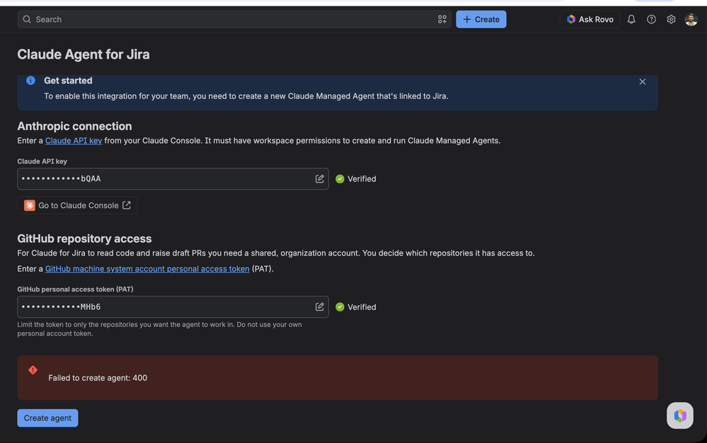

Hello,
I m setting up claude agent for jira, https://support.atlassian.com/jira-software-cloud/docs/set-up-claude-agent-for-jira/
But when i enter both API keys( claude and github ) i got error Failed to create agent: 400
I dont see exact root cause for this error and what about next steps

Hello @Ankush Katiyar , welcome! @Gor Greyan DevTools route is the right way to see the real error, and before you go there, three causes fix most 400s on this exact screen
1. The Claude key must be an API key, not a Claude subscription. It comes from the Anthropic Console, and the workspace behind it needs active billing or credits. A Claude Pro or Team login is a different thing entirely and will not validate, this is the single most common trip-up.
2. Re-check the GitHub token type and scopes against the doc. Classic and fine-grained personal access tokens behave differently, and a token missing the repository scopes the setup doc lists fails exactly like this at creation time.
3. Re-paste both keys watching for whitespace. A trailing space or newline from a copy is invisible in the field and produces a clean 400.
If all three check out, then Gor's path: the Network tab's response body usually names the failing field, and if it is a bare 400 with nothing more, that plus a HAR file to Atlassian Support is the right escalation, this feature is new enough that rollout gating is also possible, and the response body will say so.

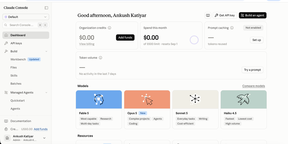

Hi @Sami Shaik
FYI, i m using claude team plan with premium seat, and i created API key from console panel https://platform.claude.com/settings/workspaces/default/keys and i don't have any credits yet.
So, for the claude for jira integration i need to purchase credits?
I think this is not needed because earlier i configure this integration with API keys and it works and due to some adjustments in jira i reinstall this integration and try to configure again with API keys and i got error 400

Ankush Katiyar
September 2, 2026
@Karishma Sharma
This integration is not free, you need to add funds in console panel first in the claude platform and than you can use.
Internally Claude agent for JIRA using claude managed agents and it's paid

Gor Greyan
August 14, 2026
Hi @Ankush Katiyar
I would check the browser Developer Tools → Network while clicking Create agent and inspect the failed request/response. It may contain a more specific validation error than the UI displays.
If it only returns a generic 400, I think the best option is to raise this with Atlassian Support and provide the screenshot, HAR file, approximate timestamp, and the failed request details. They should be able to trace the backend failure.
