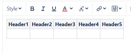

I am using behavior to set up an error on a rich text custom field if it is not updated. When I try to compare using ==, it is not working. I have a default table added on a rich text field. I want to show error message if the field is not changed/updated.

My table looks like beow:
and I got response from rest api:

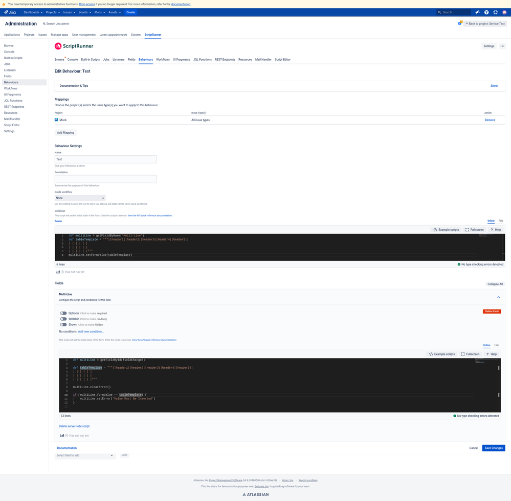

Ram Kumar Aravindakshan _Adaptavist_
June 3, 2024
Hi @Chaya,
From what you are saying, I assume that you have used the Behaviour Initialiser to create the Table Template for the Multi-Line Text Field you are using.
And your objective is to return a validation error if no update has been made to the table in that field.
You could try something like this:-
For the Behaviour Initialiser:-
def multiLine = getFieldByName('Multi-Line')
def tableTemplate = """||header1||header2||header3||header4||header5||
multiLine.setFormValue(tableTemplate)
And for the Server-Side Behaviour:-
def multiLine = getFieldById(fieldChanged)
multiLine.clearError()
if (multiLine.formValue == tableTemplate) {
multiLine.setError('Value Must Be Inserted')
Please note that the sample code above is not 100% exact to your environment. Hence, you will need to make the required modifications.
Below is a screenshot of the Behaviour configuration for your reference:-
Give this a try and let me know how it goes.
