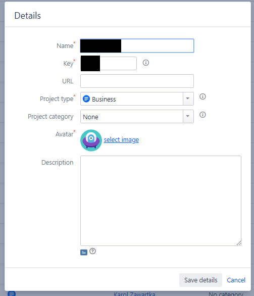

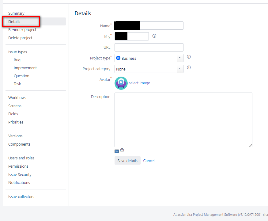

I am administrator and I don't see place where project lead can be changed.
I tried from 3 places:
1. Project setting -> details
2. Project settings -> roles and users
3. System -> projects -> edit
I am full system administrator, please help.

Dawid Skóra
October 17, 2018
Hi @Thomas Schlegel
I have attached first screen from this place, I have only option to change Default Assignee but not Project Lead :(

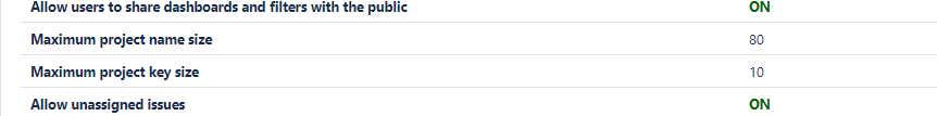

Is your project name longer than 20 characters? Then you might have this problem:
https://confluence.atlassian.com/jirakb/project-lead-cannot-be-altered-for-a-specific-project-for-jira-7-802162379.html
Dawid Skóra
October 17, 2018
