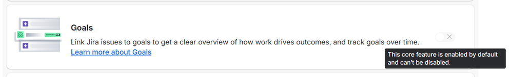

Hi Community,
I have a problem with using Goals properly on my free Jira site.
  • I have activated Platform Experiences
  • I am able to create goals
  • I can link goals to issues
What I can't do is activate the Goals feature in my project (and get the "Goals" tab in the top bar)
When I try to activate it, I get the following information which does not make any sense to me as it is NOT activated.
Do any of you have an idea what the problem could be?
Thanks in advance
Best regards
Claus

Hello @Claus Østergaard Pedersen ,
What is the type of the project/space where you are trying to enable the feature? Get that information from the Type column of the page listing all spaces/projects.
Are you following documentation/instructions to activate the feature? If so, can you provide a link to the instructions?

Hi @Trudy P Claspill
It is a standard company-managed kanban project/space.
Yes, I'm following the dokumentation for activating goals, as I have done the following:
And as mentioned, I have no problem creating goals, linking them to work items and so forth. I can even see goals for items when looking at the list view of the project/space.
The only thing a can't get to work is activating the goal feature in the actual project/space as shown in the screen print in my original post.
Best regards
Claus
Thank you for that additional information.
Can you click on the "+" button along the tab bar to the right and see if Goals is listed there? If so click on it and click Add To Navigation.
I did try that at the very beginning, but Goals are nowhere to be found - even when clicking the plus "+" button.
As my first screen print shows, there seems to be som kind of discrepancy - the slider for the feature "Goals" is clearly disabled, but the tooltip says it is "enabled by default and can't be disabled" - this does not make any sense and I'm starting to think this is a bug.
Unfortunately it is on my test-site which is on the free plan, so I can't create a ticket at Atlassian.
Best regards
Claus
If you have another site that is a paid subscription, create a ticket for that site. In your ticket let them know that the problem exists on a separate free site and give them the URL. If you are a paying customer I suspect that they will help you with your free site.
