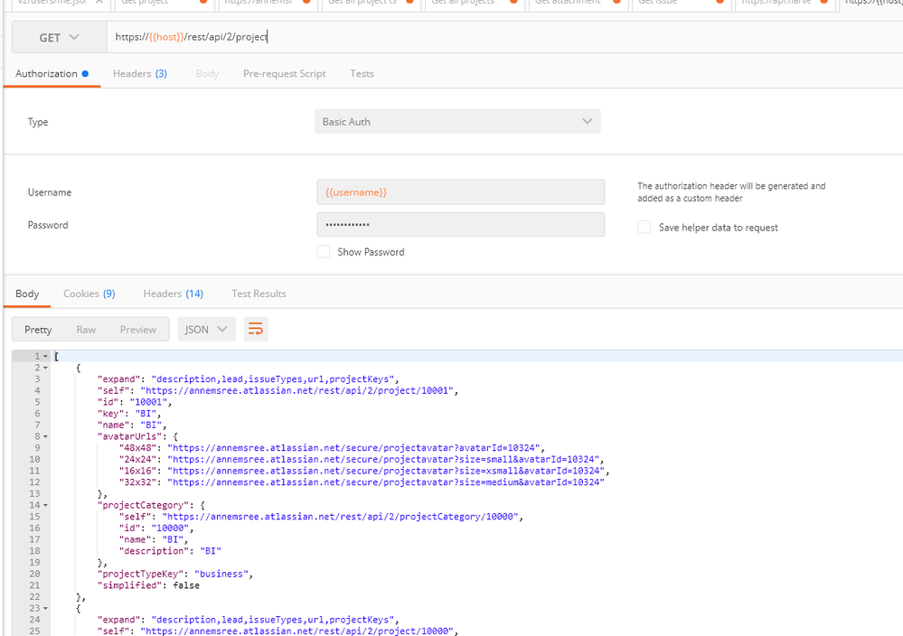

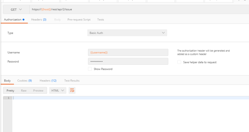

Hi All,
I have created a atlassin account for testing the Jira rest api and created a project and  tickets under it.
I am able to access the projects but not the issues under it. Please find below for more info
Could someone please help me with this.
Thanks,
Srinivas

Hi @srinivas annem,
that endpoint doesn't exist for a GET.
It only exists for a PUT to create Issues (Create issue).
Could you try a get to an endpoint below that ... for example:
GET /rest/api/2/issue/{issueIdOrKey}
With the IssueKey of one of your existing Issues?
api/2/issue

When you query issues from Jira what is the response status? I can not find it on your screenshots
srinivas annem
December 13, 2017
That is what the response, it is eempty
Alexey Matveev
December 13, 2017
Each response has a status. It is a number. If the response is successful then  it returns 2xx. In your case the response would be 405 "Method is not allowed". You could make a guess out of it that GET is not allowed. After it you should open the REST API Reference
https://docs.atlassian.com/software/jira/docs/api/REST/1000.1584.0/#api/2/issue-createIssue
You could see there that for the Rest Call you are trying to do there is only the POST method which will let you to create an issue.
You are trying to select issues, that is why you should use
GET /rest/api/2/search
