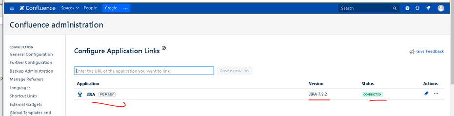

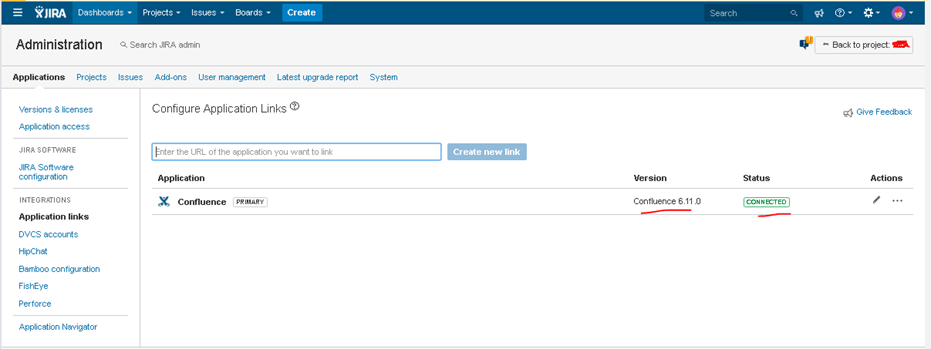

Hi Team,
    Good evening. Hope you are doing well. I have a problem switching between the Jira and the Atlassian products though both of them are integrated. Please see the Screen shot below for your reference.
Problem:
Not able to Switch between Jira and Confluence:
Jira:
 Confluence:
 But the Problem is I am not able to switch between both of them .  When i try to Switch from Jira to Confluence  it takes me to the Confluence login screen and i need to enter the credentials again to login & vice - versa. Any help is appreciated.
Thank you for your  help.

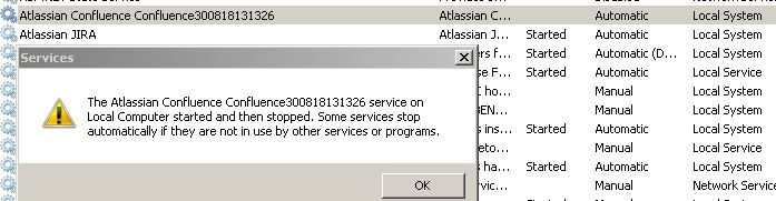

Hi Bhupati,
Best to check the Confluence logs to identify the reason why Confluence startup is failing.

bhupathi
October 8, 2018
Kelly,
  The Server.xml seems to have been corrupted.
I have un-installed the existing and installed a new Confluence server, made changes to the Server.xml
Confluence:
<Context path="/confluence" docBase="${catalina.home}/confluence" reloadable="false" useHttpOnly="true">
and configured the Application links again.
This fixed it.
Thaks kelly.
KellyW
October 3, 2018
Hi Bhupathi,
This could happen if both JIRA and Confluence applications are running with same hostname and domain in the URL(with different port number).
Atlassian applications store your successful login as a cookie in your browser called the JSESSIONID.  Your browser will store this cookie under a path for the domain, which is not port aware.  In the above examples, each instance stores the session cookie in the '/' or root path.  The JSESSIONID for Confluence is being overwritten by the JSESSIONID of the other Atlassian application.
To workaround it, run each application on a separate context path or add the sessionCookieName attribute to the <Context> element in<install>/conf/context.xml on the Confluence server.
For further reference, check out this KB -- Logging into another Atlassian application logs me out of Confluence
Regards,
Kelly

After making the Changes for some reason the Confluence service  is not starting ? Any ideas ??
Thank you.
bhupathi
October 8, 2018
confluence Service error.JPGThis is the Error message i am getting when trying to start the Confluence.
