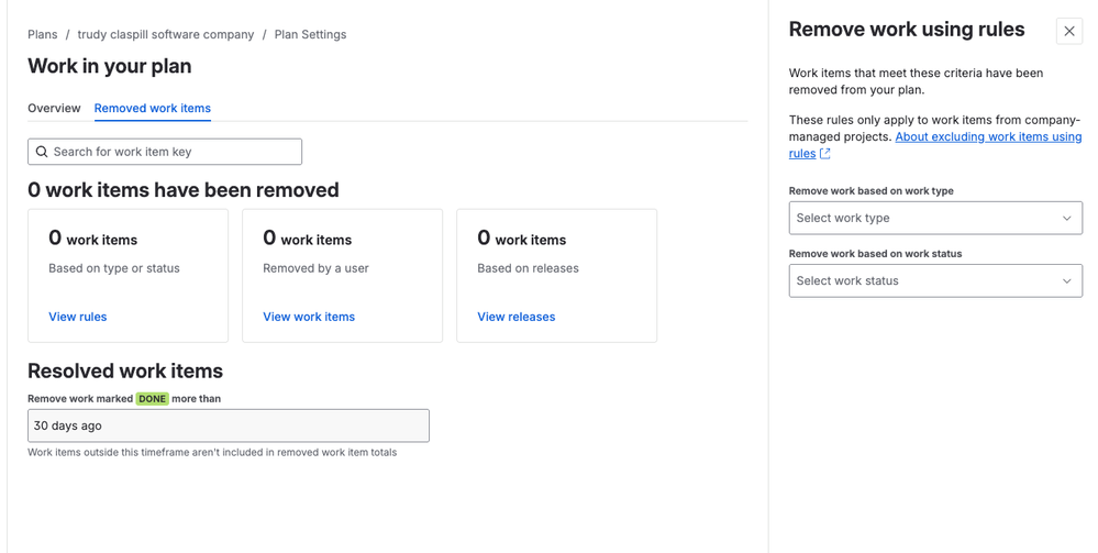

What is the source for your plan?
Are the missing Epics already marked as Done?
Check the settings for Exclusions in your plan.
  1. Go to Plan Settings > Work in Your Plan.
  2. Click on the Removed Work Items tab.
  3. Check the Resolved work items setting. If the Epics are Done and have been done for the period of time specified or longer, then they will not be shown in the plan.
  4. Click on each of the three tiles to show the details of exclusions for that area, to see if one of those exclusion options is set in a manner that might exclude the Epics.

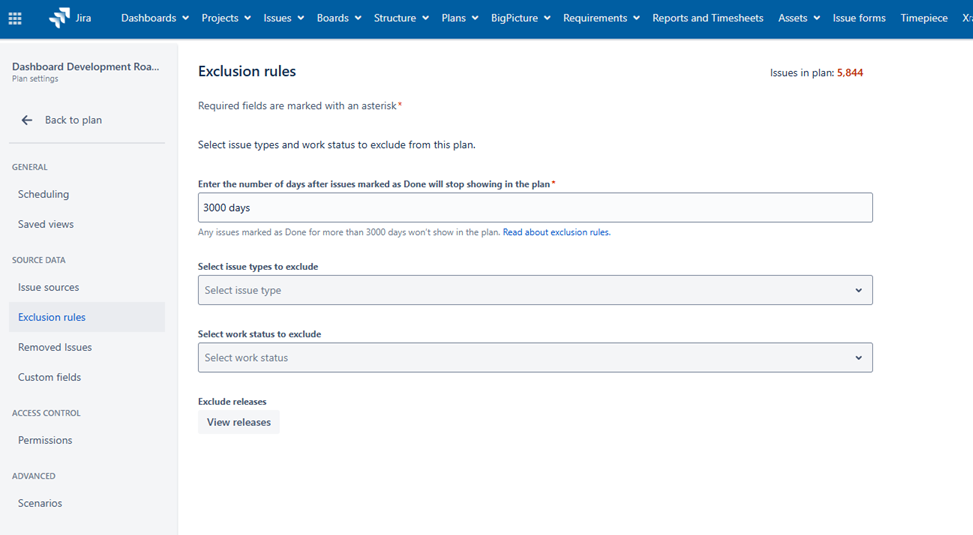

Hi @Trudy P Claspill thanks for your response. My view looks a bit different than your screenshot but here are details
Missing Epics are marked as Done. Source for plan is found for me a little different. Issue sources is coming from two saved filters. I navigated to it by clicking... Configure > Issue Sources > And in here I see my two saved filters
In left navigation bar when I click on Removed issues which I think is the same as Removed Work Items tab it's empty. Exclusion rules is empty too

Thank you for the additional information @Adrian Avalos .
While your post tags indicate you are using the Premium Jira Cloud plan, the image you provided is actually from a self-hosted Jira Data Center environment. My image was from Jira Cloud.
How long ago were the Epics marked as Done?
Do the Epics have more than one Fix Version value?
Do you have any filters applied to the view in the Plan where you don't see the Epics?
I see in your image that your plan appears to include 5844 issues. According to the latest Jira Data Center documentation Plans are limited to displaying 5000 issues. There is nothing in the documentation about what exactly happens when that 5000 issue limit is exceeded.
