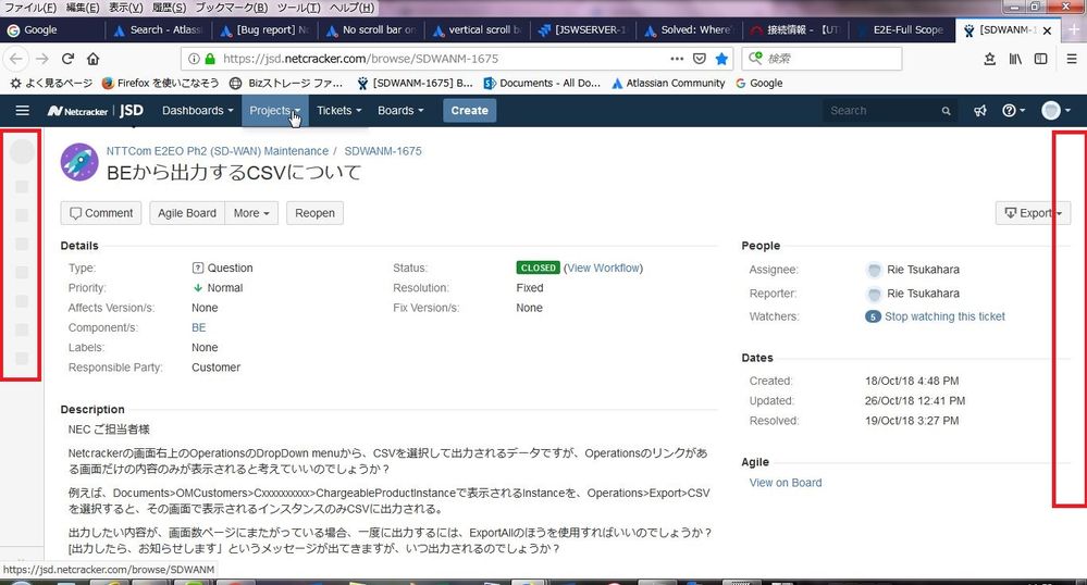

Upgrading Firefox, things stated below disappears, so some function of the Jira becomes uncontrolled.
Could you give me any solution as soon as possible?
1. No vertical scroll bar on the page.
2. Menu on the left pane such like Reports, Issues and etc. are greyout(Only grey rectangles like  shadow are shown on the left pane).
3. DropDown menus on the upper pane like Dashboard, Projects are not opend and selected.
This must be a similar issue as "EI 11 - No Vertical Scroll Function on View Issue Screen". Let me know how I should do. Workaround provided  in "EI 11 - No Vertical Scroll Function on View Issue Screen" does not work under my environment. I am in trouble with this. Please give me any solution.

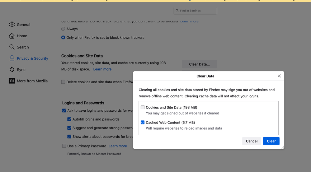

The issue is too big or very large browser cache and the solution is simply to remove the browser cache like so:
1. Open browser preferences from Firefox menu
2. Click Privacy & Security
3. Scroll to Cookies and Site Data, then click 'Clear Data...'
4. Uncheck 'Cookies and Site Data' so you don't lose your saved logins
5. Keep 'Cached Web Content' checked, then finally click 'Clear' button.
That's it. Restart your browser and enjoy your life.

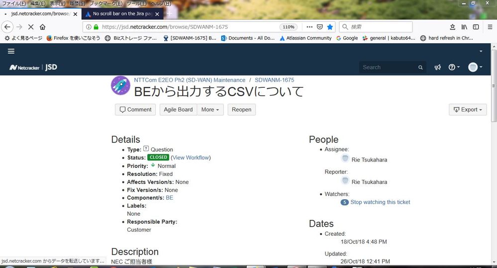

This phenomenon also occurs on Chrome Version 71.0.3578.80 (Official Build) (32-bit).
Attached files are the screenshots of Firefox 63.0.3.
WS000001.JPG shows phenomenon of 1 and 3.
WS000000.JPG shows phenomenon of 2.
Only "Create" works in the menu bar.
Others does not show the cascading menu.
Thank you for your reply and have a lovely week-end.

Daniel Eads
December 7, 2018
Thanks for this extra in fo Rie!
Based on the screenshot, I have a suspicion that this is the result of an upgrade that didn't finish successfully. Do you know if this is the case? I see the user in the screenshot doesn't have administrator access to Jira. Are you a Jira administrator?
We may need to collect some logs to diagnose the exact issue here. If it is someone else who has Jira System Administrator access, a quick way forward for them would be to open an issue from the Support Tools inside Jira. This method will send along the application logs we'll need to look at to diagnose the problem.

Daniel Eads
December 10, 2018
Does this means that upgrade of Jira was not completed successfully?
Yes, this would be the result of an upgrade of Jira. You also mentioned this happens to you on Chrome, so it would not be related to you upgrading Firefox if you can reproduce the problem in two different browsers.
I would recommend doing a "hard" refresh (clear your cache before reloading the page) to see if that has any effect before reaching out to your Jira administrator. But if that doesn't clear things up, you will need to reach out to them. They should have a look through the application logs to see if they find any errors from the previous answer.

Rie Tsukahara
December 18, 2018
Hi, Daniel
Once the problem on my Jira had converged but it come to occur again.
While this trouble is happening, the performance of the browser becomes extremely slow.
To redraw the browser, it takes much time to complete.
Attached image is the intermidiate phenomenon. This screen was shown once after login to Jira.
To redraw the browser, the screen in the image that I provided previously was shown.
